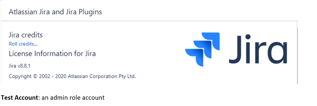

JIRA software version: 8.8.1

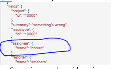

- Unable to set an assignee while creating an Jira issue
According to the example in creating an issue in both references, there is an field “assignee” in the Body Parameters with user’s account id / name. I think the ‘Create Issue’ REST API mentions in both references should support creating an issue with “assignee” which is offered in the request body.
Example in Jira Cloud platform Developer REST API v2 Reference
Create issue and provide assignee with accountId
Example in Jira Server platform REST API reference(Jira 8.8.1)
Create issue and provide assignee with name

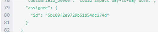

However, I encounter 2 issues in creating an issue with “assignee”:
- I try to set the assignee with name and key, but after creating issue successfully, the assignee is not as expected (it has been assigned as the basic-auth user who post the request)
- I try to set it with the accountId, however, no “accountId” in the response: please check this screenshot

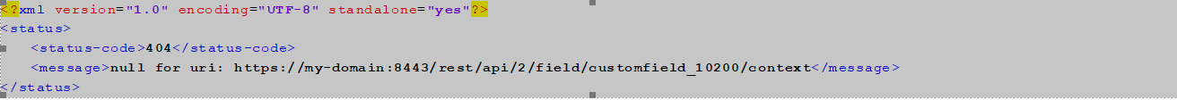

- In Jira Cloud platform Developer REST API v2 Reference, It do provide an REST Get custom field options (context) API to retrieve the options by customFieldId an contextId (GET /rest/api/3/field/{fieldId}/context)
Unfortunately, it response 404 when I try to lookup contextId by customFieldId.
Here are the steps:
Response:
Get ContextId by customFeildId: https://gbm-bds-jira.systems.uk.hsbc:8443/rest/api/2/field/customfield_10200/context
Response:
