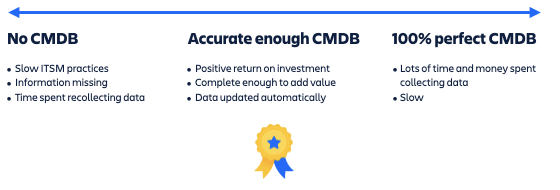

100% accuracy at all times should be the goal but in reality that may not be possible and that’s okay. As long as the data is sufficiently accurate enough to offer more business value than not having it in the first place, then you’re at net positive. Many CMDB projects can be delayed or even fail as they’re waiting to be ‘perfect’ before go-live. But sometimes it’s not worth the effort as highlighted by this diagram that highlights Forrester’s recommendations on the matter.
But as I mentioned, 100% accuracy is what we should aim for so let’s look at things we can do to keep data up to date. The advice laid out in earlier articles covers how to pick and structure your data to make it easier to maintain in the first place so check that out as well (links at the top of this post).
