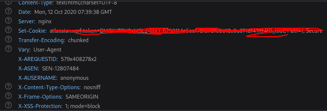

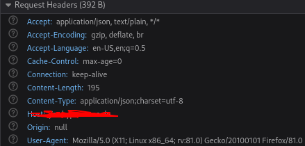

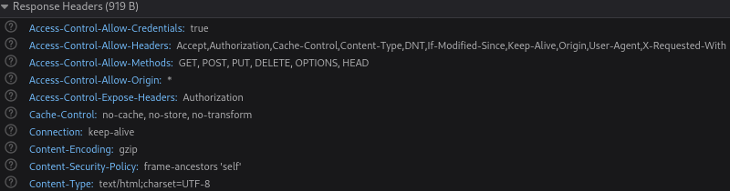

When doing so from my React APP, everything i get is the following:
Error 403 - "XSRF check failed"
So I suspect that something with the header is wrong, because this error is usually a sign, that the AtlassianToken isn't set.
Can somebody see what's going on here? Obviously, the header information doesn't reach the server.
Here is the Server Response:
