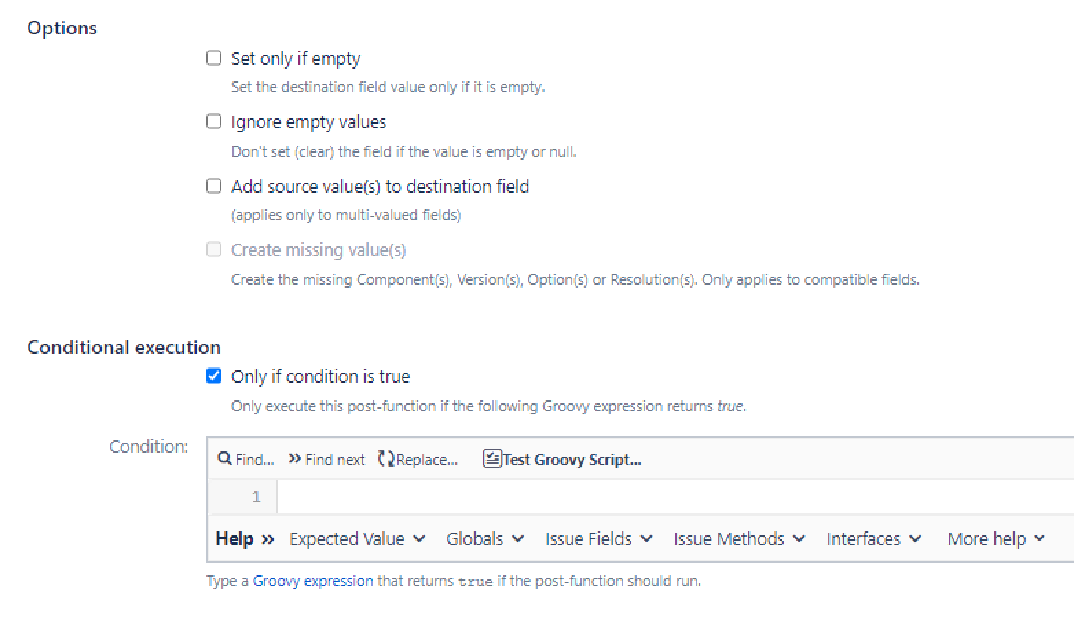

It is also possible to set the following Options or Conditional execution:
