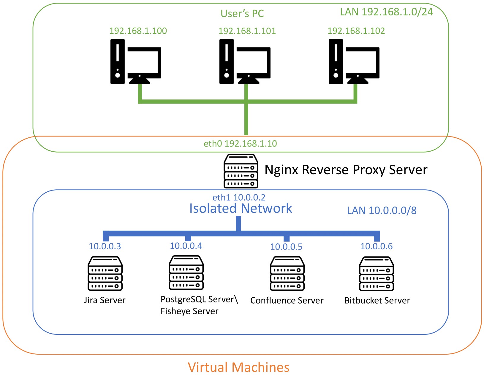

I have a hypervisor with multiple virtual machines. On one of the machines, configure a reverse proxy nginx server using the paths (www.example.com/atlassian_app)
This machine has two network interfaces: eth0 (ip 192.168.1.10) - Client network: eth1 (ip 10.0.0.2) - isolated virtual network.
The rest of the machines have one isolated network connection (10.0.0.0/8), and one atlassian application each.
There is access to each individual application from the client network.

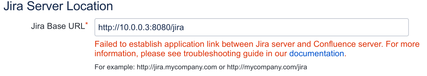

I need to link applications together.

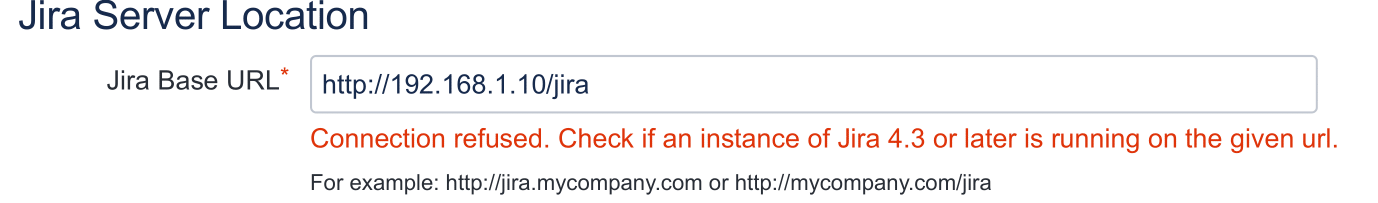

When I install confluence, the installer gives me an error. I assume that this is due to the fact that there is no access to the client network.
Is it possible to somehow set up communication between applications without giving them access to the external network?
