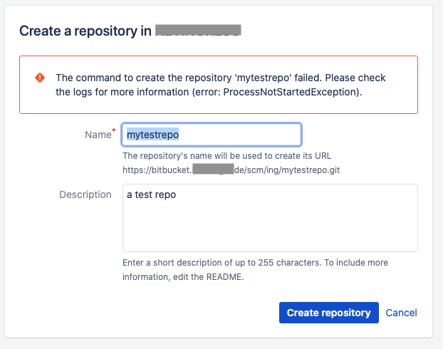

If I try to create a new repository, I always get an error message like that:

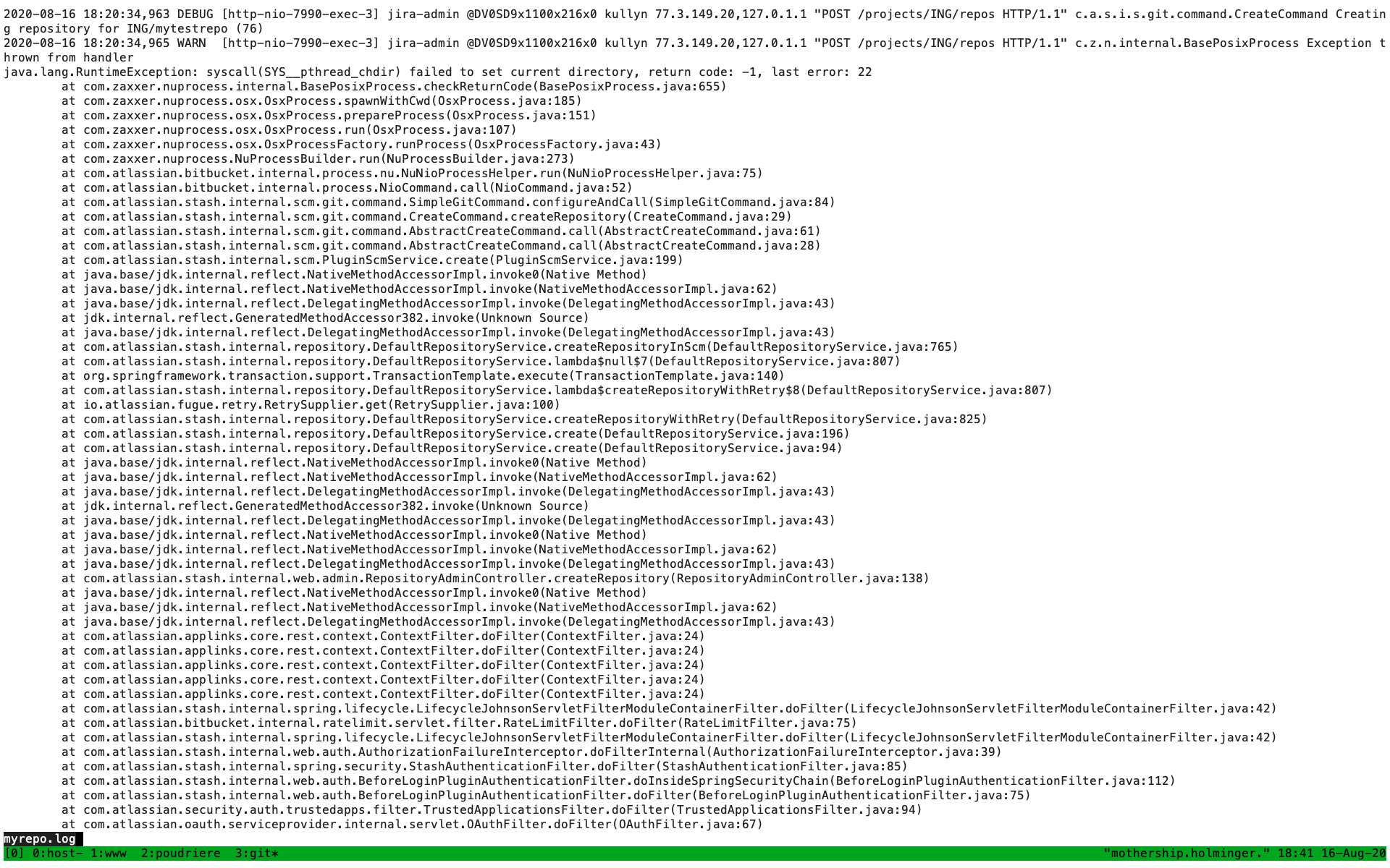

Here is the corresponding output from the log:
