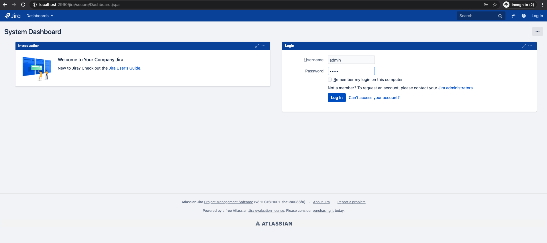

You can open http://localhost:2990/jira in your browser and see this Jira instance running in docker:

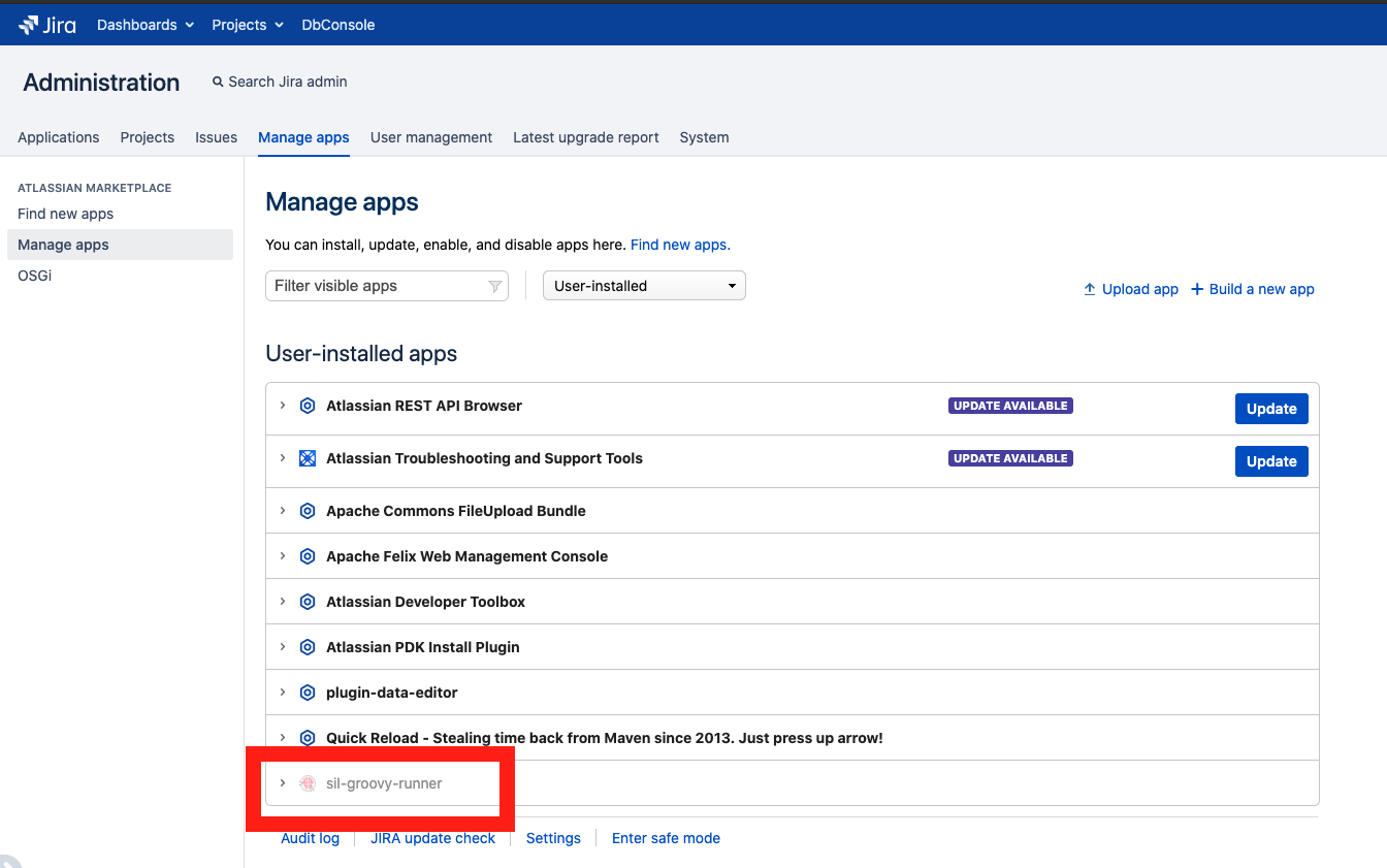

Now open manage apps in your Jira instance and you should see the plugin there:
As you can see the sil-groovy-runner app is there. But why is it disabled?
I believe in your case it will be enabled. In my case this app should be installed on a Jira instance with SIL engine available. I do have this dependency in the pom.xml and I would like to run my app not through the atlas-run-standalone command but atlas-debug command. How to do it?

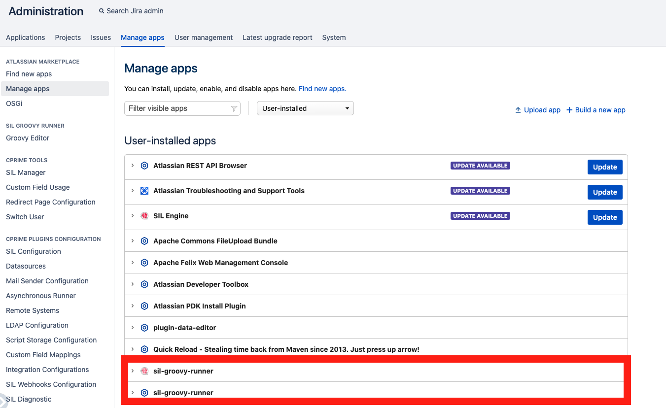

After Jira was started we open http://localhost:2990/jira in our browser and go to Manage Apps
Our plugin is installed and enabled.

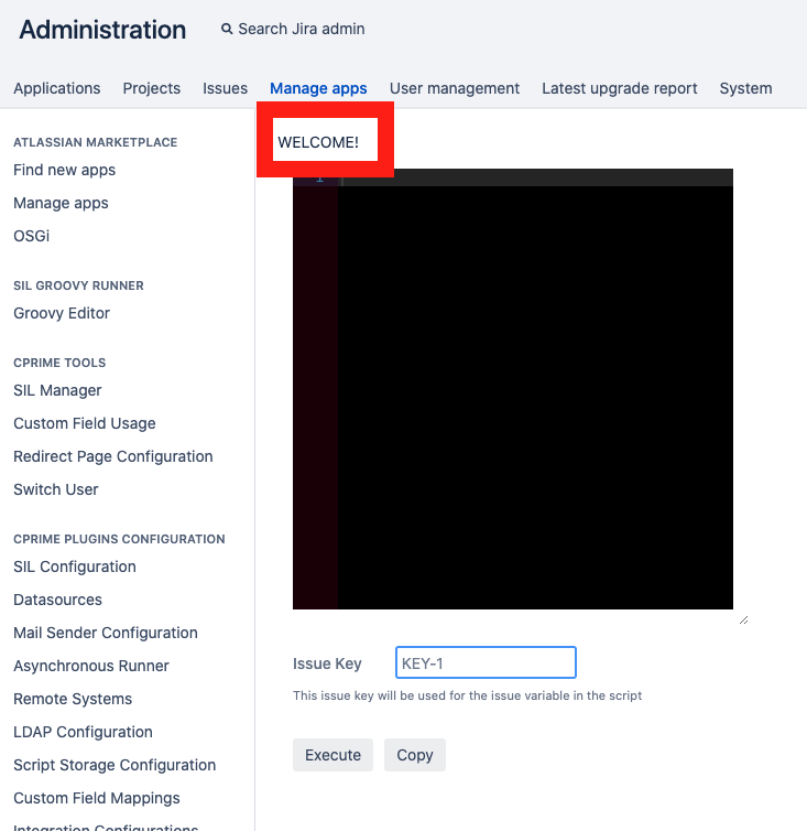

Now let's try to make a change to our app and see if the change will be seen in the docker.

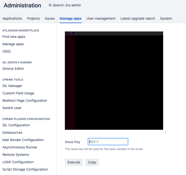

Let's open Groovy Editor in my app:
Before the Groovy Editor text field let's write WELCOME!
I made changes to the code and saved the file. I made changes to a soy template that is why I do not have to package my app. The changes should be visible now. Let's have a look:
Everything works as expected!
