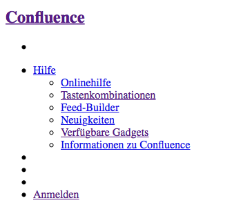

I have installed Confluence on a Ubuntu box. The default config (using Tomcat directly on 8090) works fine. But the config with Apache and SSL fails because only links and basic HTML elements are visible. The skin (colors, frames, menu, layout, etc) is missing.
