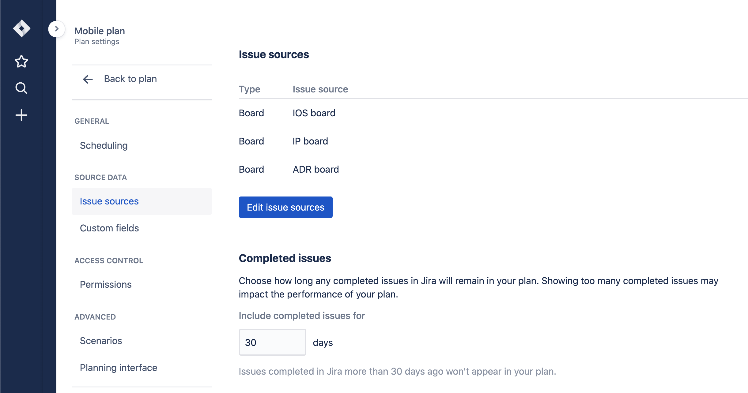

2. Use team boards as your issue sources
Advanced roadmaps can be flexible in how you want to source issues into a plan. You can select a project, a board or a Jira JQL filter to source issues to your plan. However, what may not be immediately clear is that some options are more constrained than others and may limit functionality. For this reason we recommend using Boards as the issue source, particularly if your needs from the tool revolve around Capacity planning.
It's best to ensure a board captures all the work relating to a specific team. This is simple to achieve in the case your team relates directly to a single project. In other circumstances where you have a teams that works from a shared project, or a team that works across multiple projects - we encourage defining a filter for that specific team and then creating a board from that filter.
To achieve this, you may define a specific variable (label / custom field) to associate the issues to the team. Alternatively, you could use the 'Team' field that comes with Advanced roadmaps as that variable.

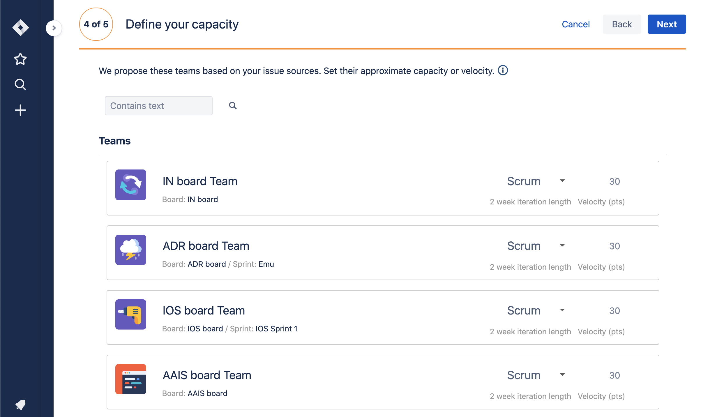

3. Defining Teams for Advanced roadmaps.
Teams is a feature that comes with Advanced roadmaps. A team stores the the team type (kanban/scrum), team velocity, iteration length (for scrum team sprints), associated issue source (connects sprint data when associating a board) and the team members. There are 2 types of teams: Private and Shared.
Private teams are defined within a plan and cannot be used outside of the plan (though they can be visible on issues if you add the field to the screen).
Shared teams can be used across different plans, and can also be assigned to issues from Jira. Private teams can be converted into a Shared team from within a plan, or a shared team can be created from the "Manage shared teams" page so long as they have permission for it.
When you create a plan, a new private team will be automatically defined for each issue source you select. If you've already established shared teams for your issue sources then you can delete the auto-generated ones. Additionally, you should remove the team that may be created for the "Initiative" issue source, as those issues don't really belong to a team.
After you create your plan, in the Team tab you can add shared teams into the plan or create new private teams. Importantly, ensure the teams also associated to their issue respective source. This is how Advanced Roadmaps is able to associate which sprints are associated with which team - needed for the Capacity planning functionality.

When you create a plan, there's a step to include releases. It's important to select all releases you want to include in the plan. Excluding a release will also exclude all issues assigned to that release. (Issues without a release or new releases created in the future will automatically be included in the plan).
In order to keep plans hygienic, we have a default setting so that issues completed 30 days ago will automatically be hidden. This keeps plan data relevant, reduces mess and prevents performance issues due to increasing issue count.

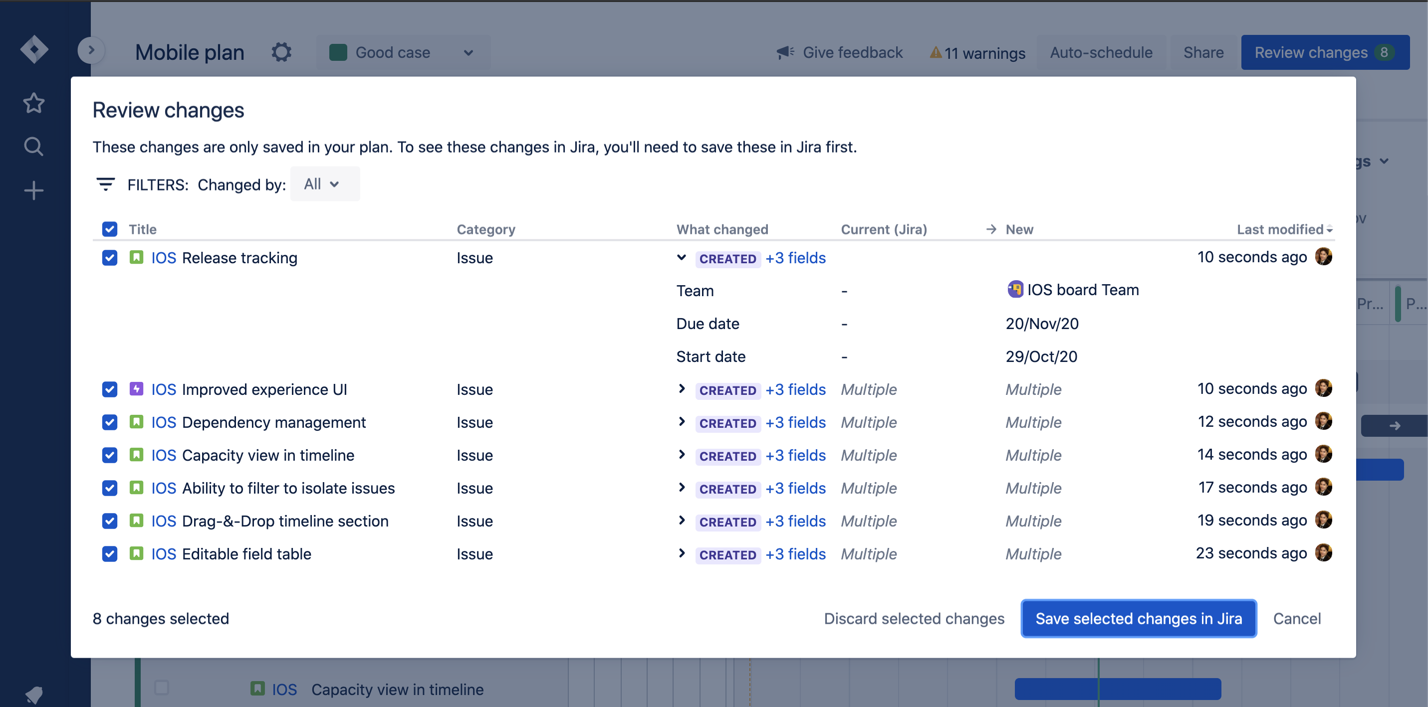

When you create issues in the Plan view, you may notice it doesn't immediately get an issue key. it also won't be created in Jira at that point. This is because Portfolio uses a 'Sandbox' data model. As issues are updated in Jira, those updates are visible in the plan. However any updates you make in the plan won't update Jira until you decide. So you can 'play' with your plan as you figure out the most effective path of delivery, without concerns of messing around with the team's issues. When you're ready to commit to the plan or particular changes, you can save them from the Review changes modal.
