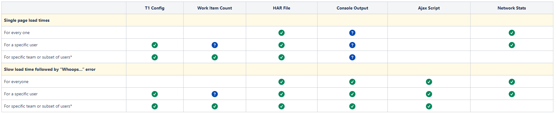

When we have the above three items, support will then require some of the below data points. Support may require more data, but in most cases, the below would be sufficient to progress the investigation to a point where we understand where the problem is, even if there is not an immediate fix. Depending on the problem, the data set may be different so please use the table below to select the symptom that is the closest match to what you are seeing and then collect the data with the green circle/checkmark in the column. Anything with a question mark in the column, support will ask you for if they need it - feel free to have it ready but it may not be needed unless deeper investigations are needed. Instructions on how and when to collect the data will follow after the table.
NOTE: This table is not set in stone and does not cover every scenario. It is here to illustrate some common issues and the data needed in most cases.
*= note what makes this team or set of users different from the rest, if anything. Different roles for example.
If you are seeing the "spinning wheel" that never goes away, it is possible that an error is hidden. Please open the Console and attempt the navigation again, and if you see a 500 error, use the same Ajax script you would use for a Whoops error.

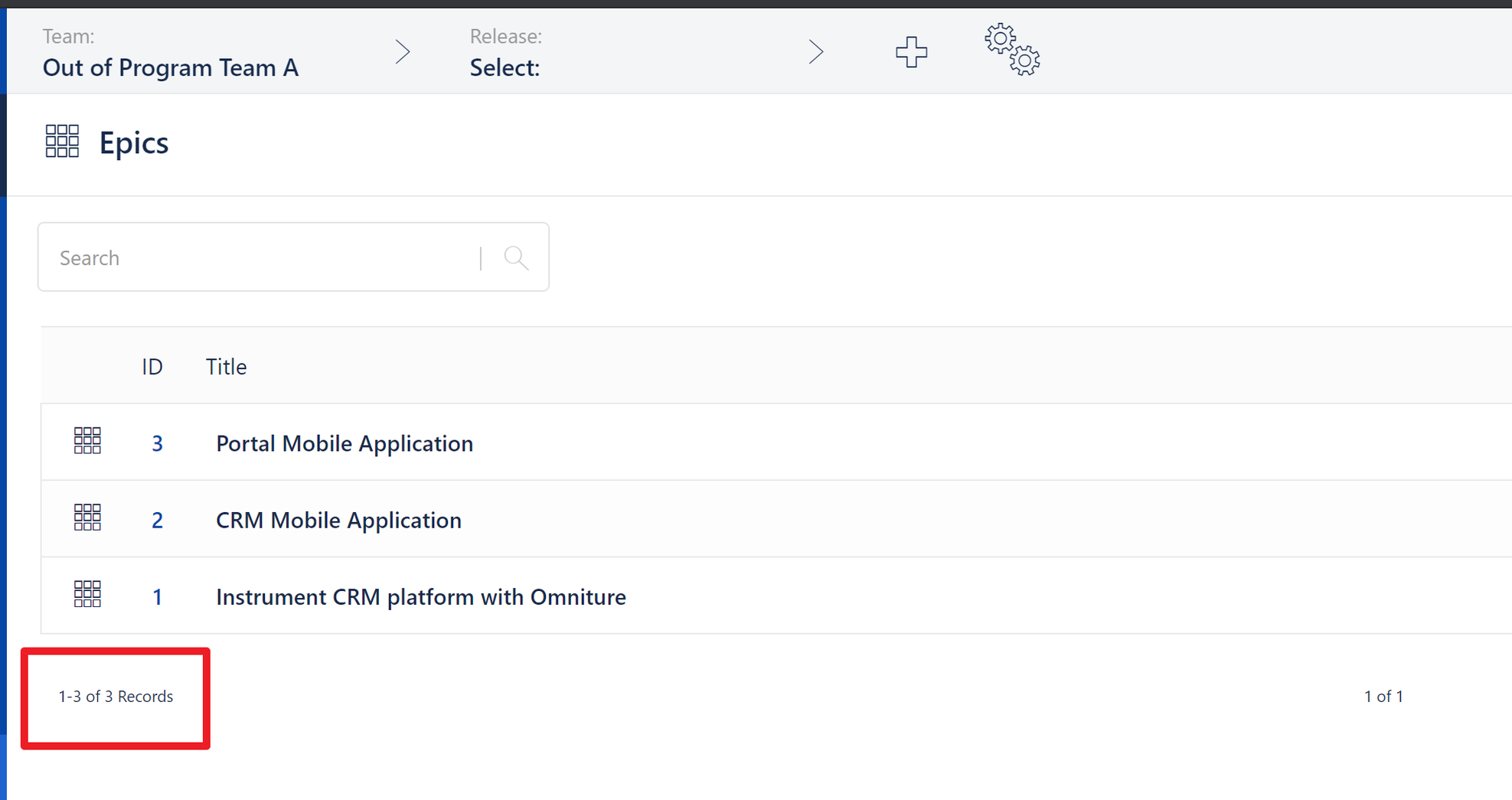

Work Item Count
When performance is impacting a certain team, much like T1 config, it can be related to the amount of data that the team needs to deal with. By work item counts, we mean navigating to the individual work item grids and getting a count of items this team is dealing with, for example on the Epic Grid (but we should get a count of every item type the team would work on):

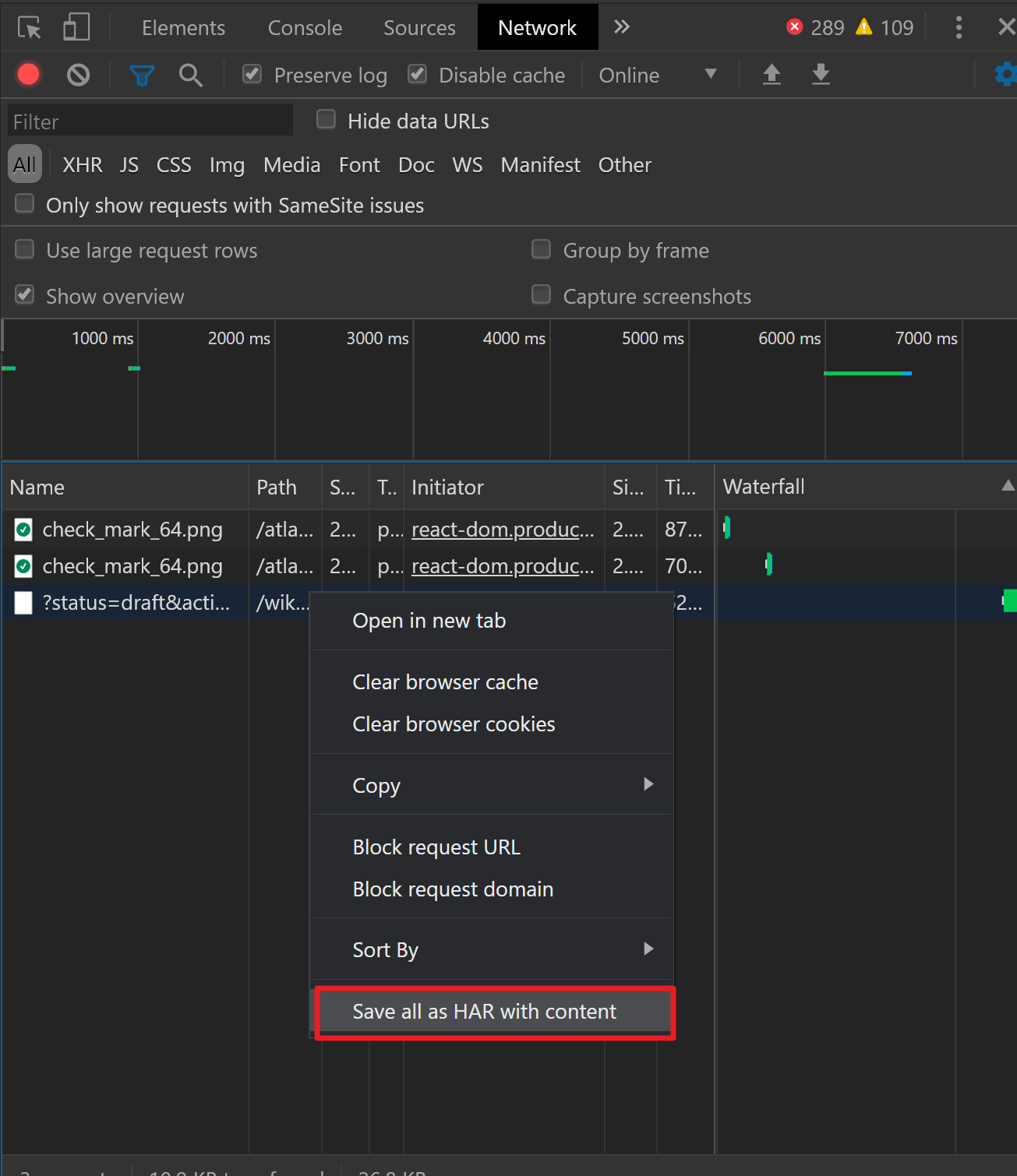

HAR File
A HAR file typically will not show the answer but will offer a number of clues. It will show Support and Engineering what navigation steps were taken to get to the problem, call timings, specifically latent calls, etc etc.
Start the capture before you reproduce the issue. Capturing a HAR file when the issue is not present will not provide any useful information. It is better to wait for the problem to be present than getting incorrect data.
For detailed instructions and troubleshooting please see this Atlassian KB, but if you are using Chrome it is straight forward:

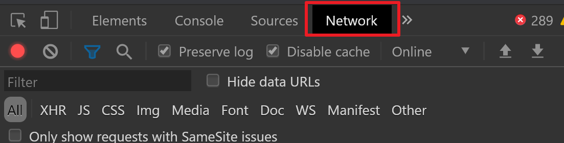

Click on the three dots in the top right to open the menu, More tools, Developer tools
In the window that opens, click on the Network tab:
Recreate the problem
- When you are done, right-click inside Developer Tools and then Save all as HAR with Content:
- Attach the file to your Support ticket

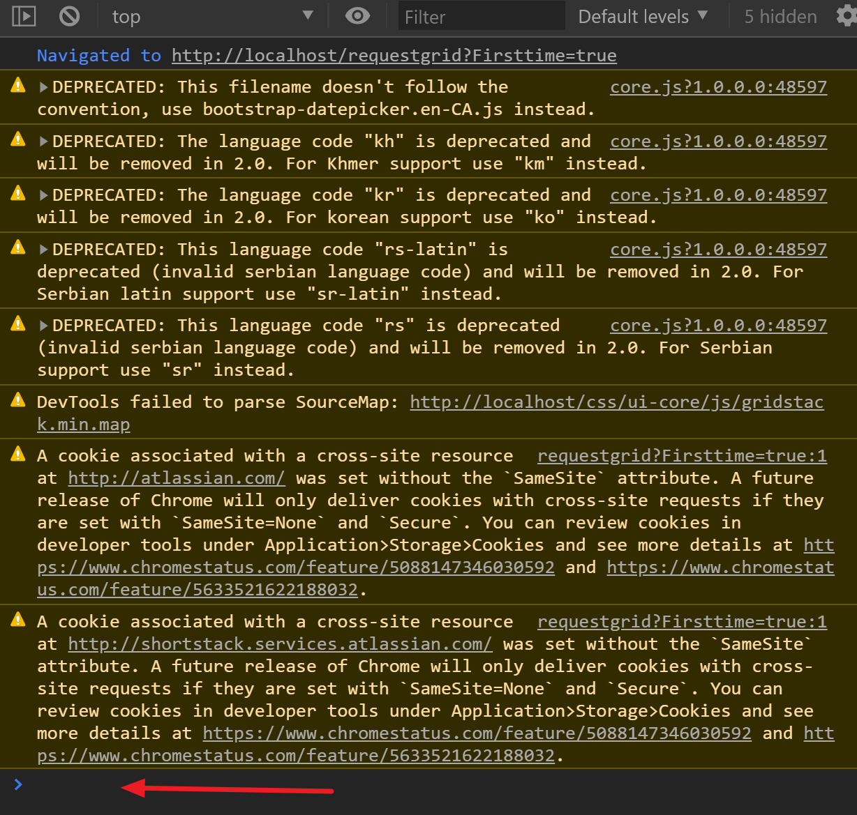

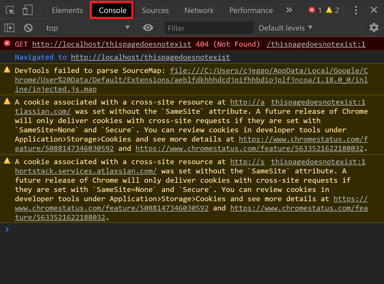

Console Output
Sometimes the Console gives away some clues as to an underlying problem. To get to it, just open up your Developer Tools in Chrome and click the Console tab:
The red stuff is usually bad " data-emoji-id="1f61e" data-emoji-text="😞">😞 . Take a screenshot and attach it to the ticket.

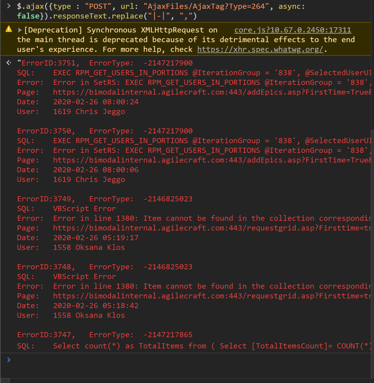

Ajax Console Script
If you are here then you are probably seeing a Whoops screen (or you saw a 500 error in the console tab). Take a read of The Dreaded Whoops Error post but for Engineering teams, the Whoops tells us nothing. The below script will pull out the actual error behind it.
You need to reproduce the issue BEFORE running this, including all navigation steps. If you get a blank output, we are either chasing the wrong kind of error OR the error was not reproduced properly.
Navigate to the page throwing the error i.e. reproduce the problem
Open Developer Tools and go to the Console tab
Select the empty line and paste in the ajax script:
$.ajax({type : "POST", url: "AjaxFiles/AjaxTag?Type=264", async: false}).responseText.replace("|-|", ",")
Sample output
The output can be long and run off the side of the screen like the below screenshot. In that case, please copy/paste it into the ticket or a text file.
