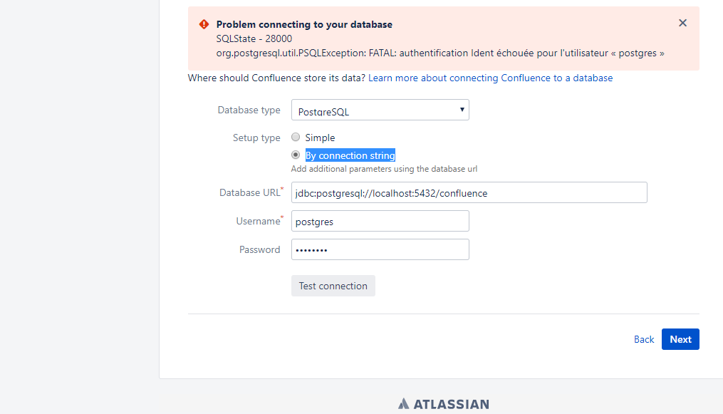

I installed confluence and postgres , when i try to connect my database to postgres , for the simple way , when i hit test connection : it looks succeded as picture describe below :
But when i hit next to finish the configuration , it takes a while and i get this error :
psql: FATAL: authentification Ident échouée pour l'utilisateur « postgres »
By connection string , the test failed :
I see that i have to change the pg_hba.conf and i did it : Here i my file :
