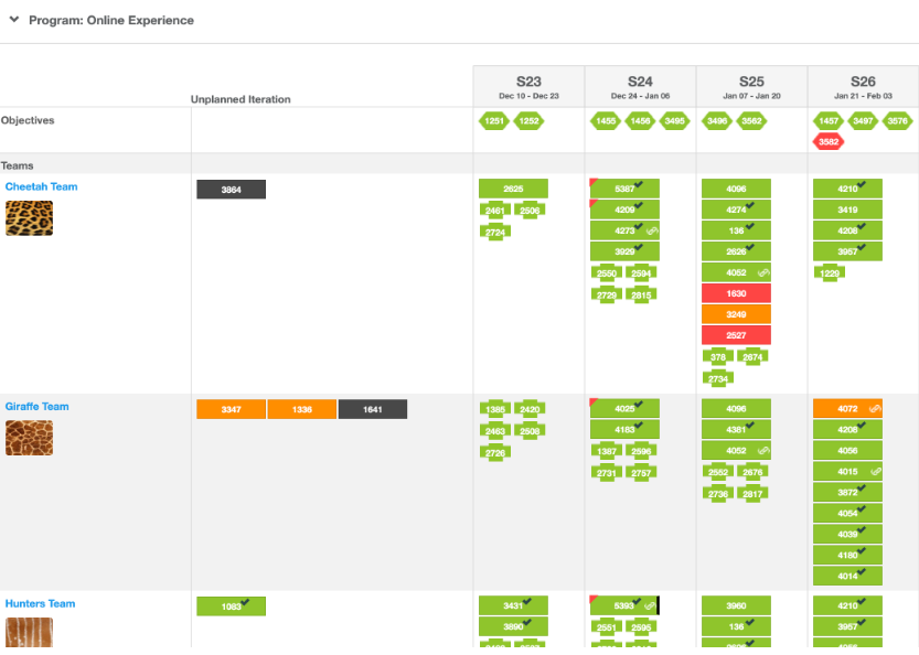

The Program Board during a Program Increment
The picture below shows how the Program Board might look a couple weeks into the plan. Features and objectives are being completed, dependencies are being delivered, and you can see work that teams are going to do but haven't yet planned.

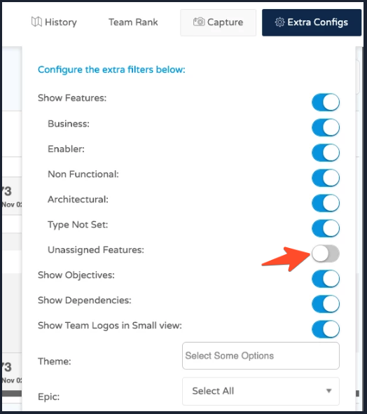

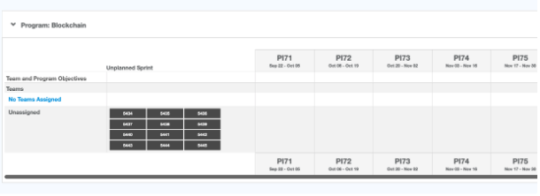

In order to see which features are planned in the planning cycle, you need to go to the Program Board and pick Extra Configs and turn on Unassigned Features. That way you can see all the Features that teams have already written stories for along with all the Features that do not yet have stories. This is shown below:

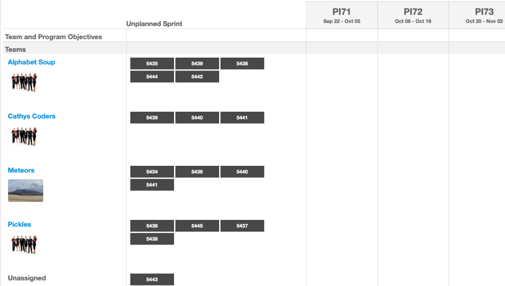

Once that switch is set, you can see the Program Board with all the features. (In this example below, let's assume none of the teams have started writing stories.)

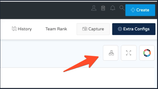

(In these screen shots, we're looking at the small view of the Features. You can change the view to see larger Feature icons with more details by clicking the View Icon in the upper right.)

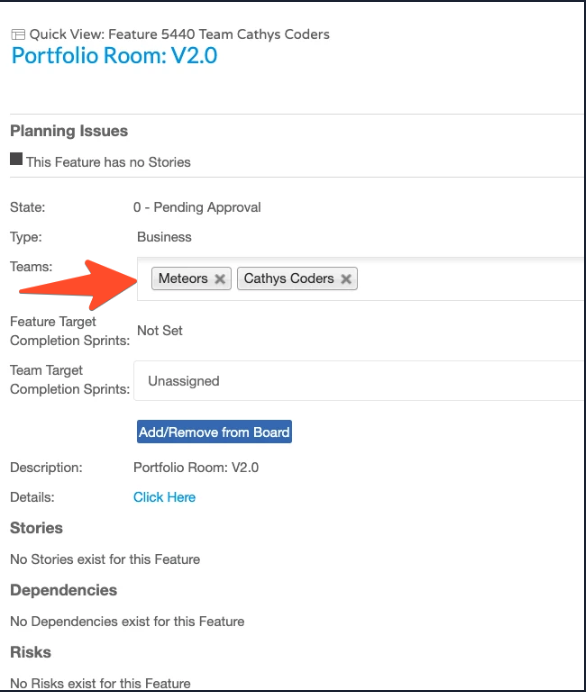

Each team can look at the features that are planned and decide if they will contribute stories. The teams that will contribute can identify themselves on by clicking on the specific feature.
Once the teams have identified themselves, the board can be updated and it will look like the same below:

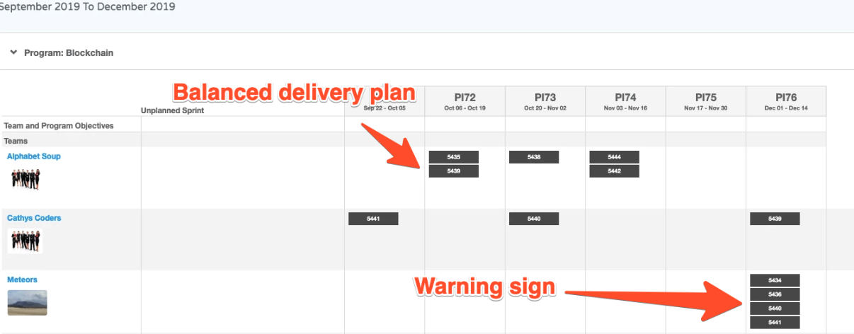

As each team goes through and lays out its own plan for how it will deliver its work, it can update the Feature with the target sprint for when it will be done with all its stories. (Read my colleague Rob Phillips excellent article about using the Sprint Iteration view in the Team Backlog to see how to lay out a plan.)
You can bring the whole team together to look at the Program Board as each team is planning out its work. We assume each team is confident about what is going to do in the very next sprint, and there's decreasing levels of confidence as we move further out. However, it's worth taking a look at the plan as it is being laid out. If some or all the teams are finishing all their work in the last sprint, that's a warning sign.
