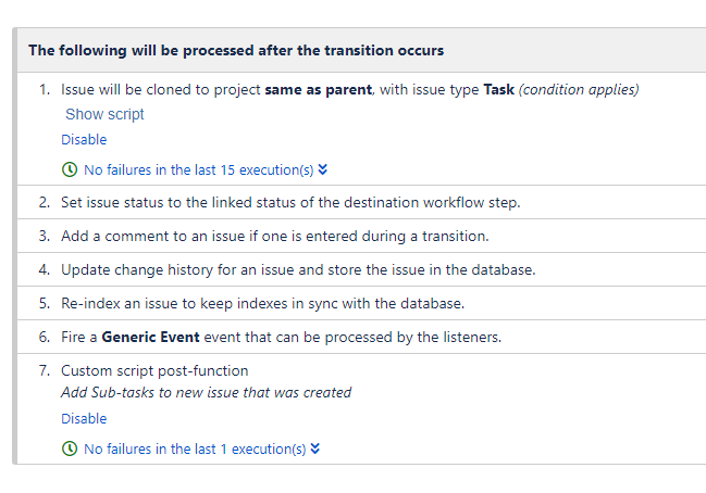

So we have a transition that when fired does the following:
- Creates a new issue via clone of type "Task" via a postscript step 1 (works fine)
- Based on Field on original issue (that is copied to new issue) will create appropriate sub-tasks on the new issue via a second postscript step 7 (works fine for sub-tasks but not doing epic link to main issue created in step 1)
I finally deleted and rewrote the script in step 7 without actually setting the value on the new issue and it shows no errors. But any time I had option of setting the epic link it would just fail. So I am getting my subtasks but the new issue is not being linked under the epic it should.

- Also tried moving the location of the script in step 7 to different order of the postfuction steps but that tends to just break everything even the new sub-task creations.
