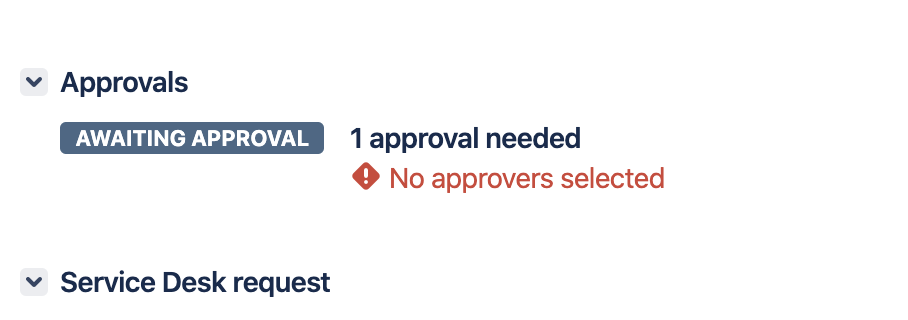

The Problem I have is that when a Portal Users selects the "submit" option on a Service Request ticket, the Approvers field is not populated.

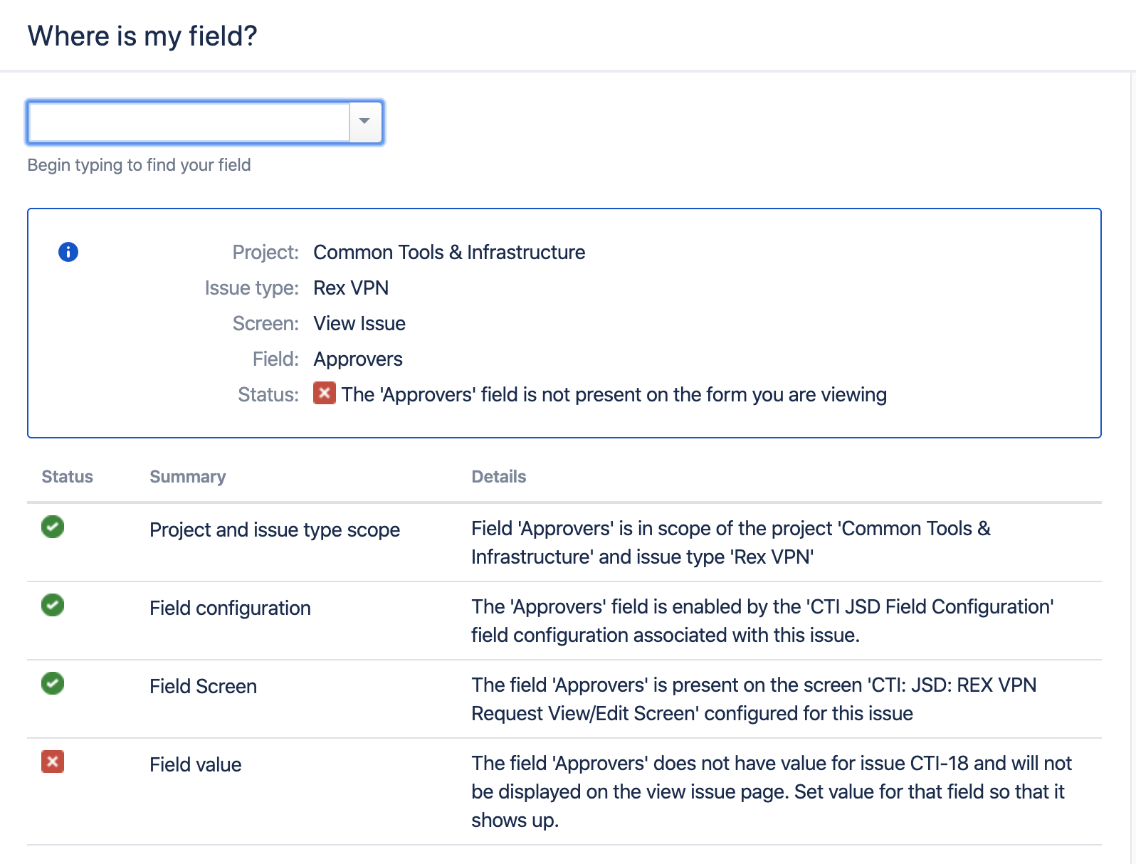

Everything works if the ticket is created using the Agent view, however, the approvers field does not get filled in when the ticket is submitted for approval from the Portal View. The scrptrunner script reports script was successful and I can even see in the output of the log of the script that it retrieved the correct values from the User group.
I just constantly get the error that "No Approvers selected" if Submit is from Portal View. The ticket can be created in the Portal View and then an agent can Submit, and the field is populated correctly. This is not feasible, nor efficient for how the process is set up for us currently.
