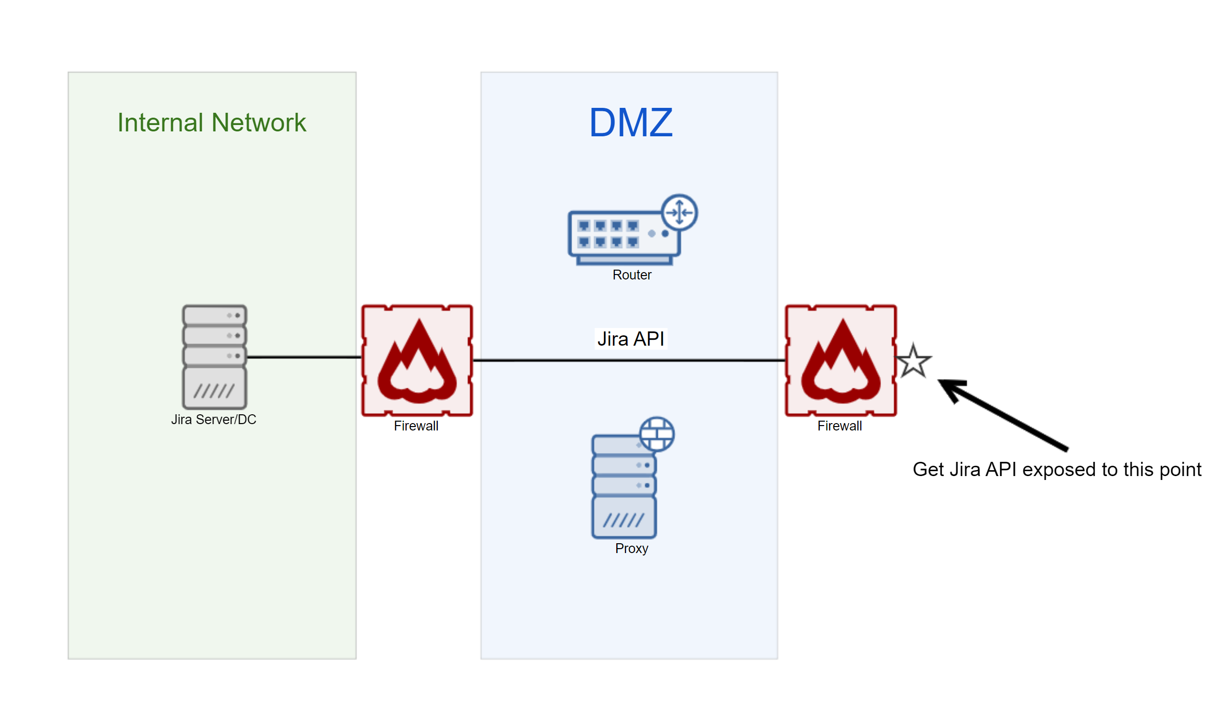

Although the below diagram a huge oversimplification of a network architecture, it illustrates the end goal - expose the Jira API to the edge of the network so Jira Align can communicate with it.
How this is achieved will vary depending on the environment, but generally, we are talking about one or a combination of three options after Jira has been configured:

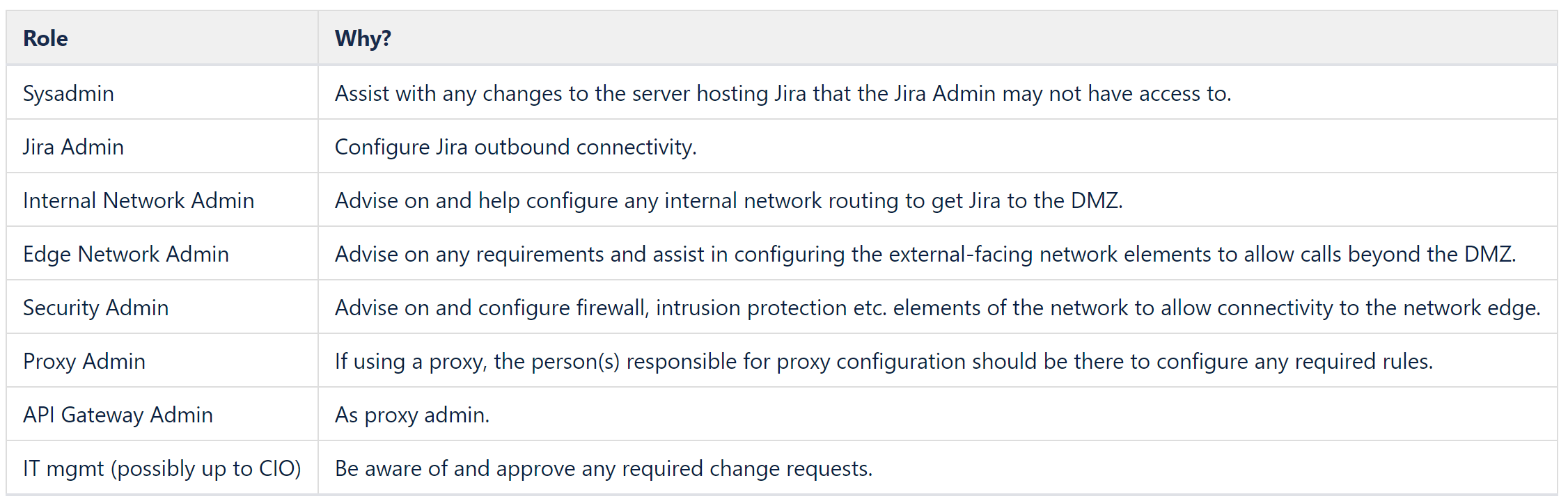

Which technical teams need to be involved?
This is a non-exhaustive list of the typical people involved in connectivity projects. Role names may differ between organizations. It can help to have a network diagram to hand and trace the route that data will have to take to get from Jira to the edge of the network, then involve whoever owns each piece.

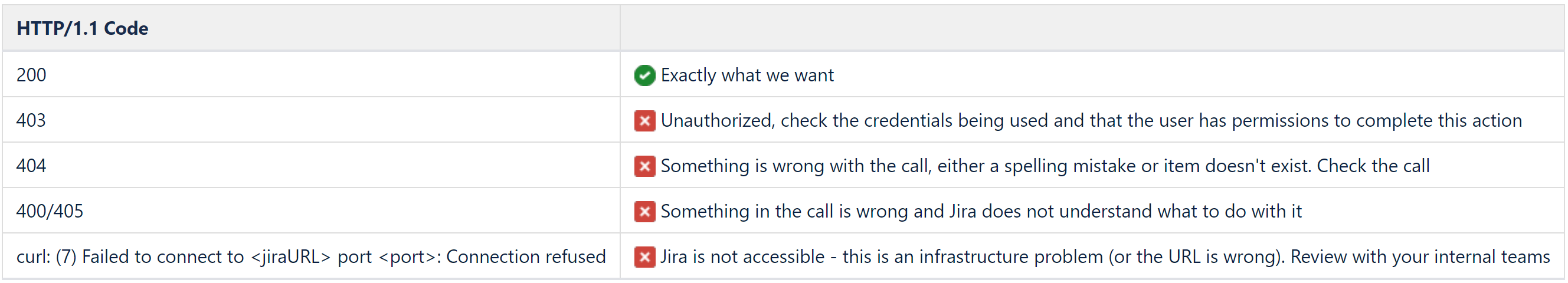

Expected response
HTTP/1.1 200 X-AREQUESTID: 636x513x1
