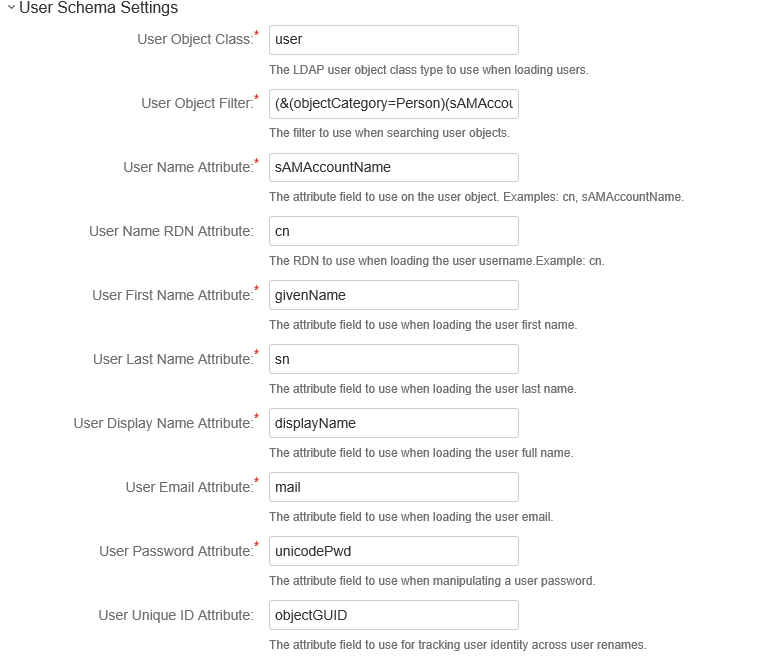

Our Jira instance is configured to get directory info from a local LDAP server. User Schema settings are pasted below. The exact attribute of sAMAaccountName and objectGUID do not appear in our Azure configuration according to the IT engineer. He’s used onpremisessamaccountname and objectid as substitutes during the various configuration attempts. I’ve also tried setting the azure configuration for userid to various attribute values including the onpremisessamaccountname. When I manually point the userid reference to an attribute then the login error changes to attribute not found in SAML response packet.
