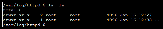

In the documentation it states that the access log for Confluence is located at /var/log/httpd/confluence-access.log. When I access the running docker container and look for that log file, it's not there. The directory /var/log/httpd is there but there is no log file in there.

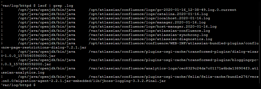

When I do a "lsof | grep .log" I can't see any open log files called "confluence-access.log".
