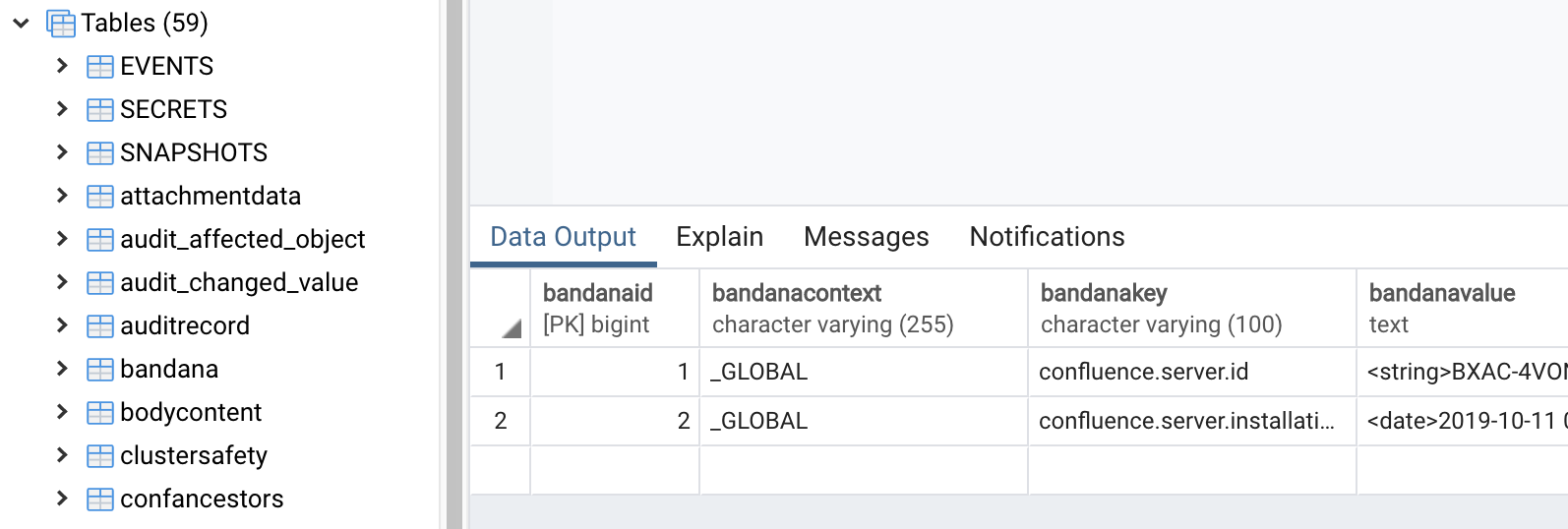

Preliminary Investigation
The table bandana did exist and there were data in it
