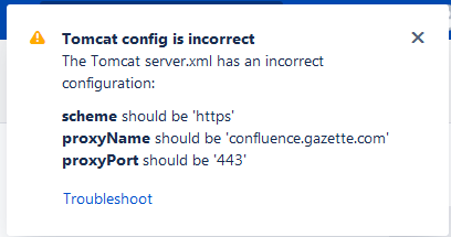

After our linux administrator installed an SSL certificate he is currently receiving the following Tomcat config is incorrect error:
He stated he followed the troubleshooting article at https://confluence.atlassian.com/confkb/can-t-check-base-url-warning-in-confluence-6-6-or-later-939718433.html and verified the settings are correct. Most likely this is due to the article being dated. Below is the server.xml file:
