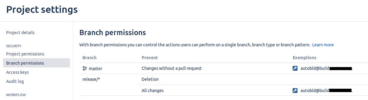

I would like to allow pushing without pull request to master for one user/host (the SSH key is configured in the BitBucket). For this purpose I go to the "branch permissions" in the "Project Settings" (because I want to configure it globally, for any repo of the project):
I tested this way perfectly for "release/*" branches, but for some reason it does not work for master. I get the error message when I attempt direct push:
remote: Branch refs/heads/master can only be modified through pull requests.
remote: Check your branch permissions configuration with the project administrator.

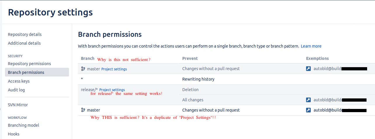

As a workaround I have to do this in the "branch permissions" of the repo in the "Repository settings" like this:
On the last picture it is clearly visible that the "Project Settings" are already inherited, thus from the healthy logic there should be no sense to duplicate the same setting in the "Repository Settings", which is especially weird that for "release/*" it works without it.
So the workaround works.. But I don't want to do it for each repo! I find it pretty straightforward that if it works for a normal branches then it must work for master as well.
Otherwise it must be clearly explained in the documentation what is the reason of the restriction.
However I checked this guide https://confluence.atlassian.com/bitbucketserver/using-branch-permissions-776639807.html and I did not find any mentioning that for master the behavior is different.
I am now thinking about submitting a bug. I would appreciate if someone confirms it is is a bug or not or refer the proper documentation where this behavior is described as expected.
