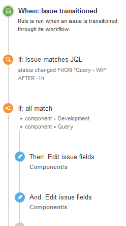

We have something setup using JQL but it is affecting all tasks that were changed in the ;ast minute.
JQL: For the transition from Query - WIP: "status changed FROM "Query - WIP" AFTER -1m"

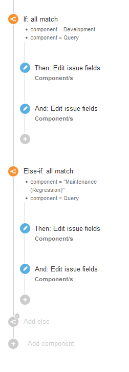

I use an IF/ELSE condition where:
IF Component/s = A AND Component/s = E THEN clear Component/s and populate with A.
Else Component/s = B AND Component/s = E THEN cleat Component/s and populate with B.
I will attach a screen shot of my rule setup.

My initial setup:
The If/Else Statement:
