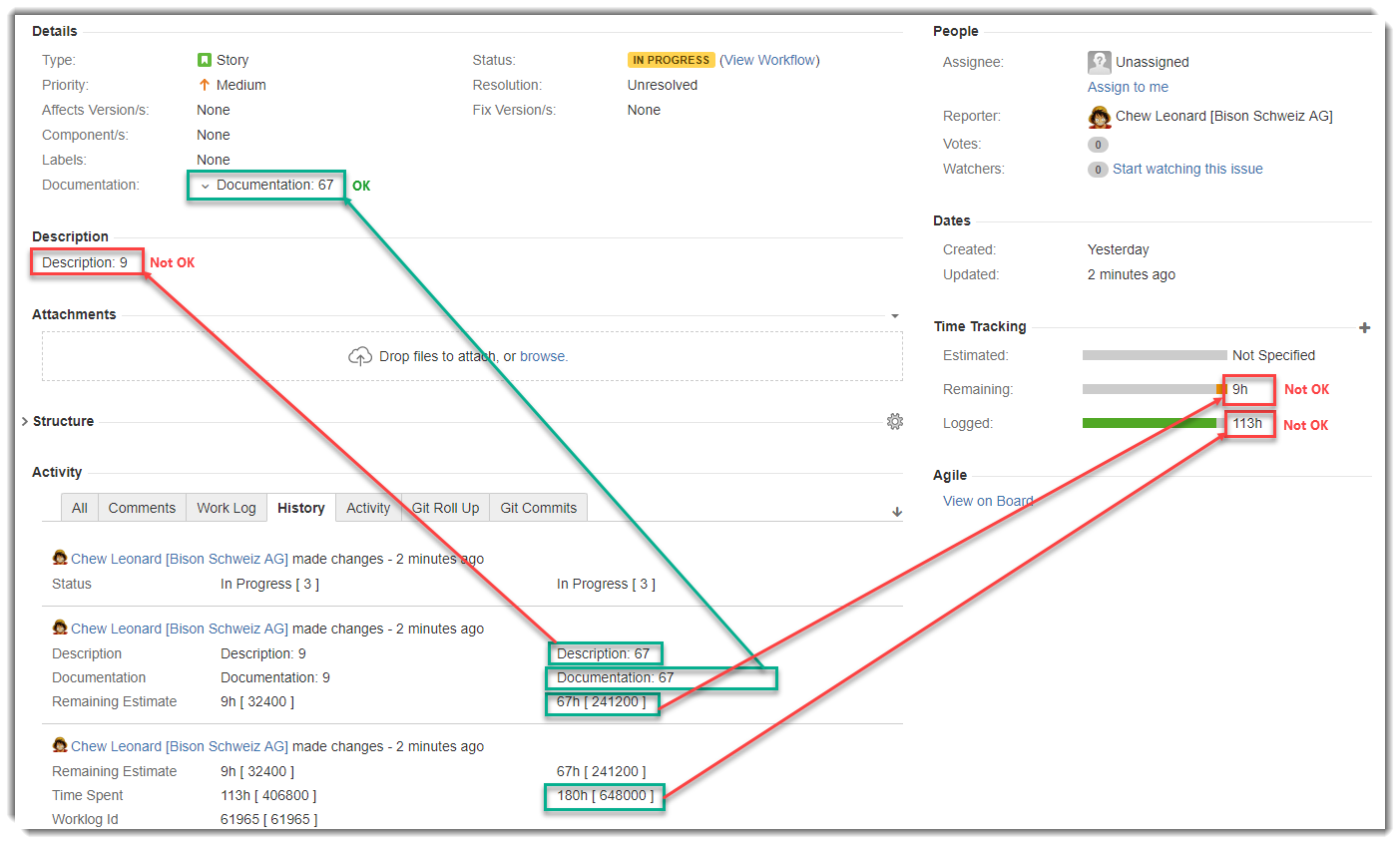

There are no errors thrown and the logs are all correct.
This screenshot also shows you that the changes are protocolled in the history, but the (red) values are not written on the issue:
