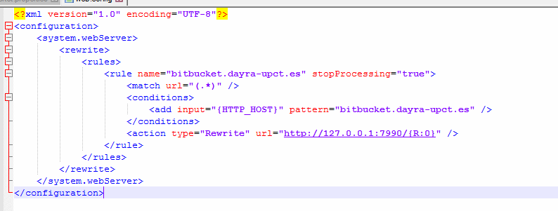

IIS as reverse proxy listening on port 80 and it redirect to my bitbucket server listening on 7990 port.
My configuration on IIS server as reverse proxy is the following:

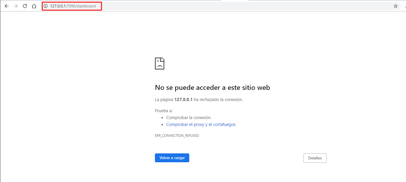

And here is the error. When I access from my computer to URL "bitbucket.dayra-upct.es", in my browser the URL changes to "http://127.0.0.1:7990/dashboard" and evidently in my Windows 10 computer there aren´t any bitbucket in my personal computer.
Here is the problem. The URL changes on my browser!!! I have similar configuration working fine with Confluence and JIRA with IIS proxy reverse. I cant understand what is the reaseon why bitbucket not working...
