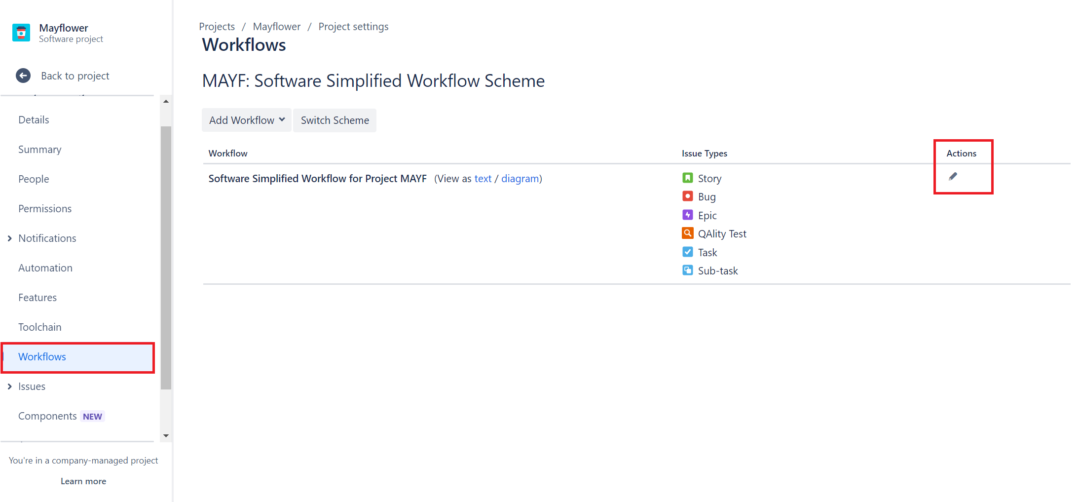

1. Go to the workflow configuration for the selected project
The solution described below is available only in company-managed projects. Moreover, only the Jira project administrators are able to change workflow configuration and therefore add issue transition validators. If your project is company-managed and you have the necessary permissions, you can find the workflow configuration page in the project settings on the left-hand menu. Go there and click the pencil icon next to the workflow scheme assigned to your project and issue types you want to configure validators for.

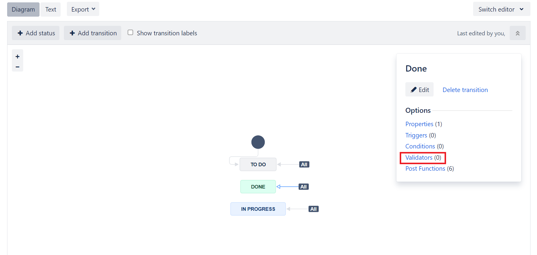

2. Select appropriate issue transition
Issue transitions are represented by arrows from one ticket status to another. For example, you can have a transition from the “To Do” status to “Done”, as well as a transition from the “In Progress” status to “Done”. Once you have clicked on the transition you want to add validation for, click on the “Validators”.

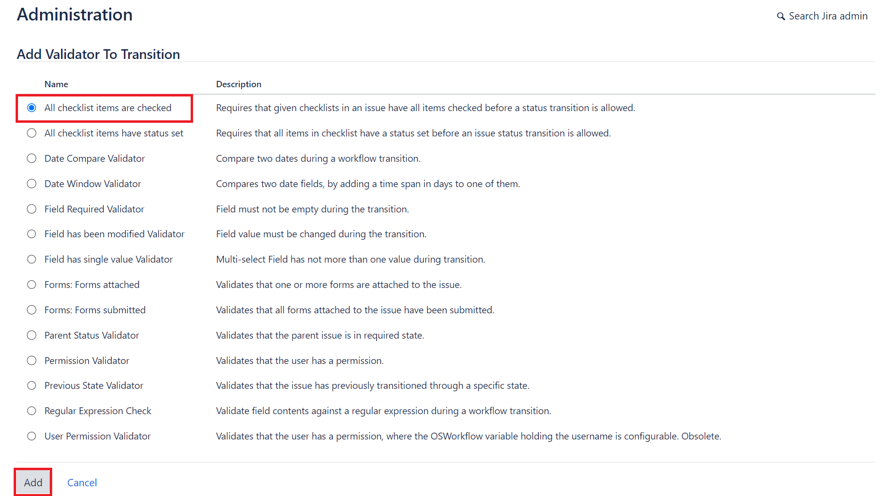

3. Select the checklists validator
From the list of all available validators, select the “All checklist items are checked”. Once you click “Add” you will be asked to enter the name of a checklist that you want this validator to be applied to. You can also leave this field empty - in that case the validator will be applied to all checklists.

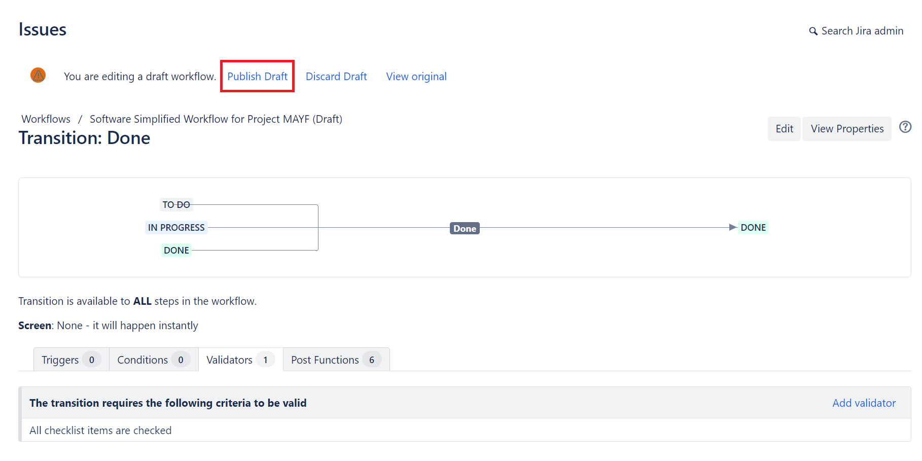

5. Save the workflow scheme
Once you have added the checklist validators to all of the transitions you wanted to, one step that remains is to publish the workflow scheme. To do so, click on the “Publish Draft” above the workflow diagram.

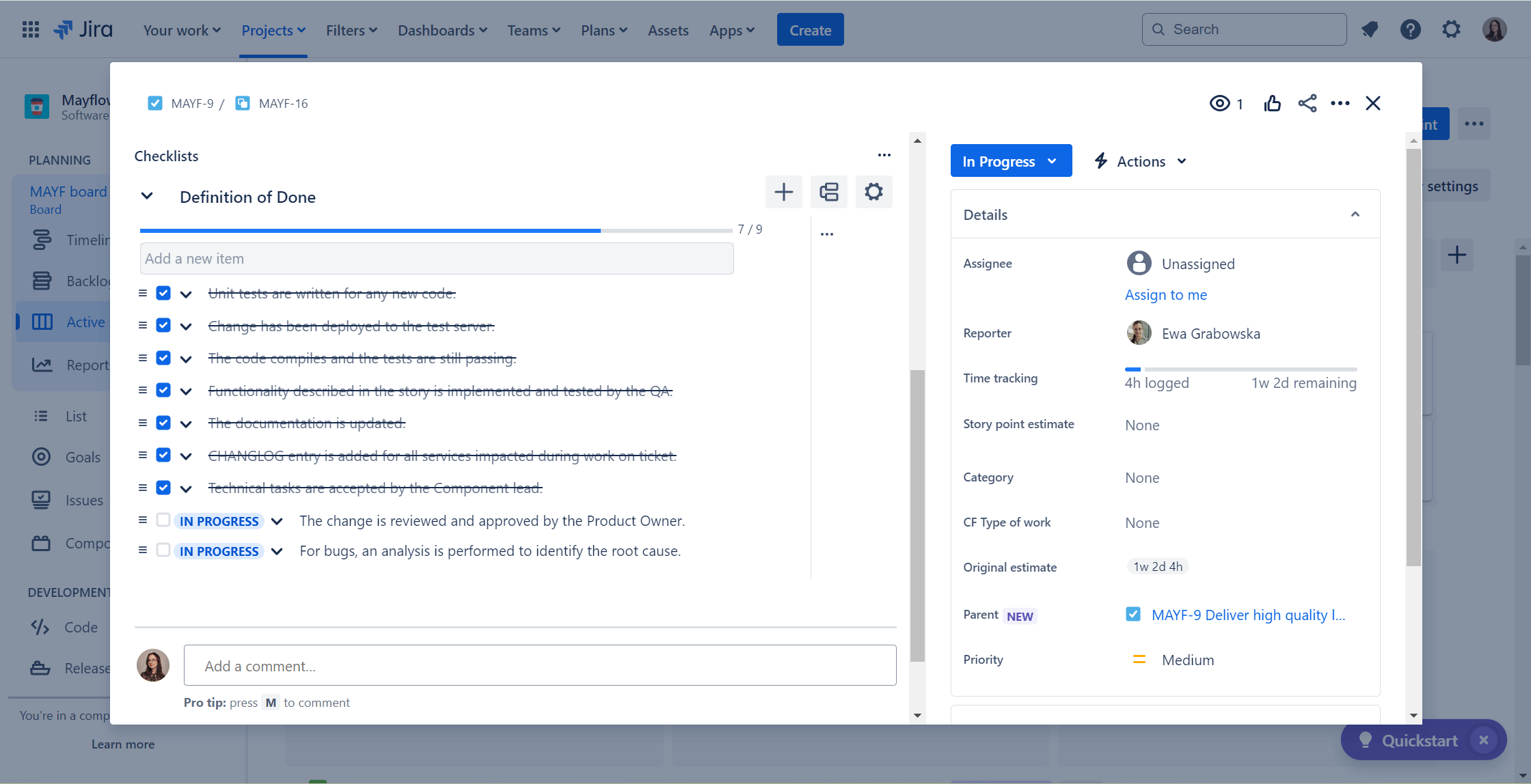

6. Test it out
Once the adjusted workflow is published, the transitions that had the validator added will not be possible until all checklist items are marked as completed. This won’t affect issues that don’t have any checklists added or that don’t use checklists. Try it out yourself! Add a checklist with some items, and try to move an issue through a transition that is protected with a validator.
