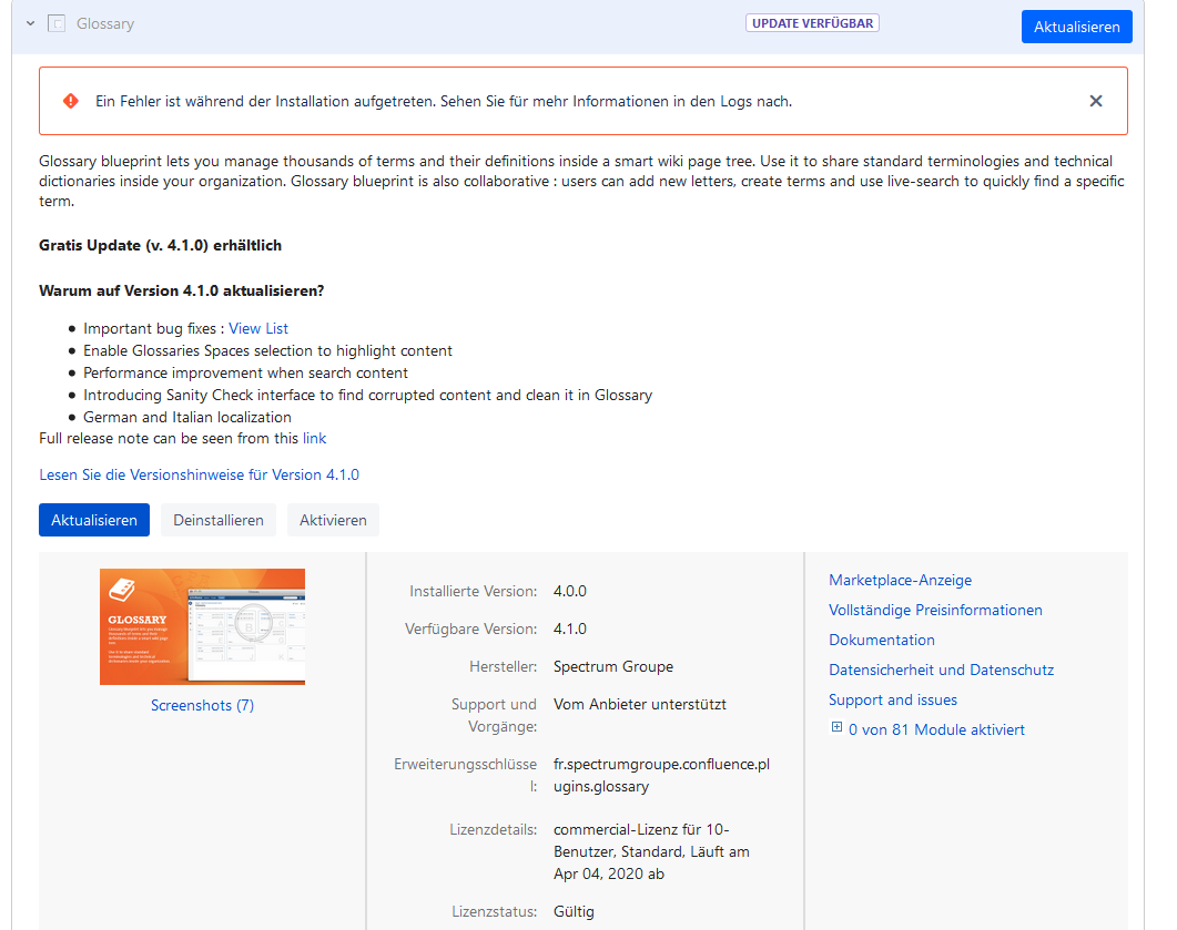

Hi,
We are unable to remove, update or enable an add on, glossary, whether I am in safe mode or not. In addition, I have installed Atlassian Universal Plugin Manager and afterwards, I couldn't remove or update this plugin.
The following image is the error occurs on update/remove.
The error found in the log is stated under this message.
Please let us know how can we fix the plugin?
Thank you.
