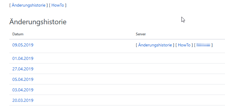

I'm trying to build a server changelog sorted by the date. For example:
Date Server
13.05.2019 [Server1 Server2 Server3]
12.05.2019 [Server2]
Therefore my structure looks like this:
Changelog
--- Page1 (13.05.2019)
--- Page2 (12.05.2019)

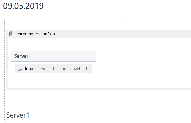

On the date page I'm using the 'Table of Contents' plugin in a table enclosed by the 'Page properties' macro.

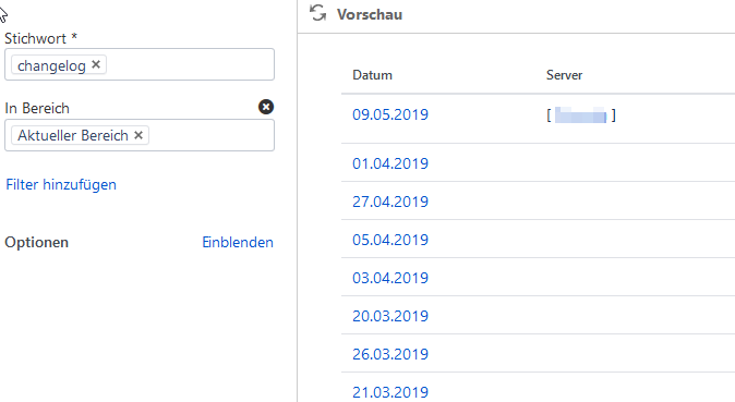

On the main page I'm using the 'Page properties report'.
Unfortenuately it isn't working like expected. The report just shows the properties of the actual page (despite the preview does it correct).
