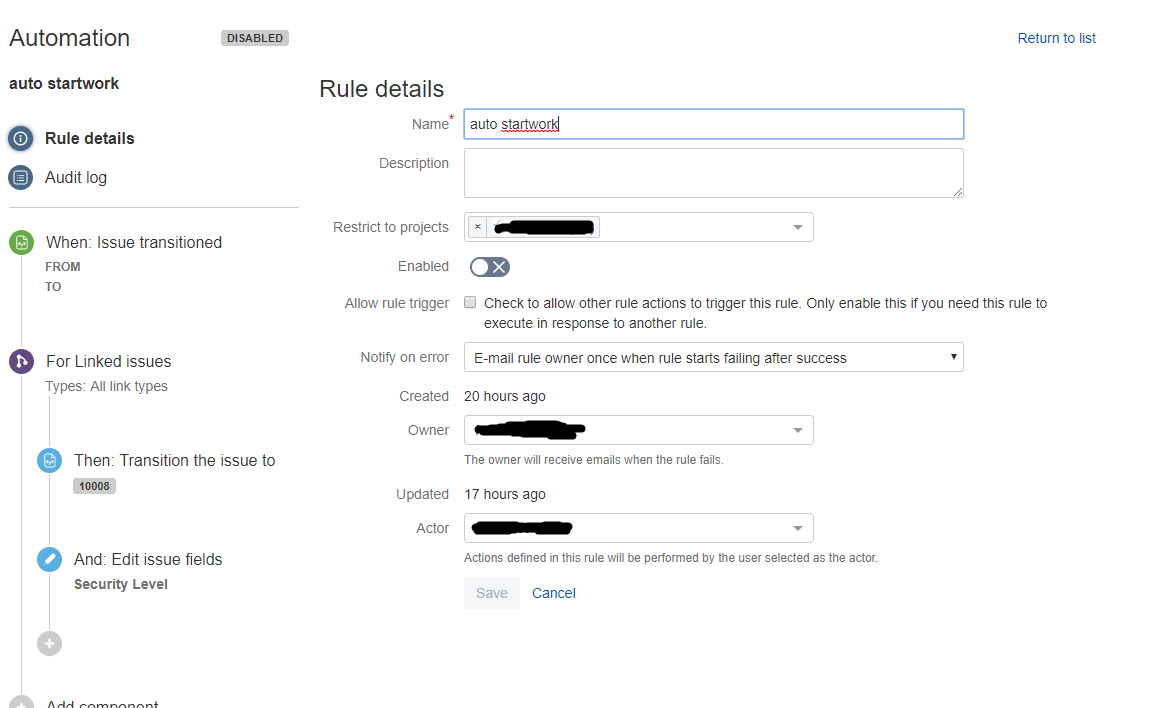

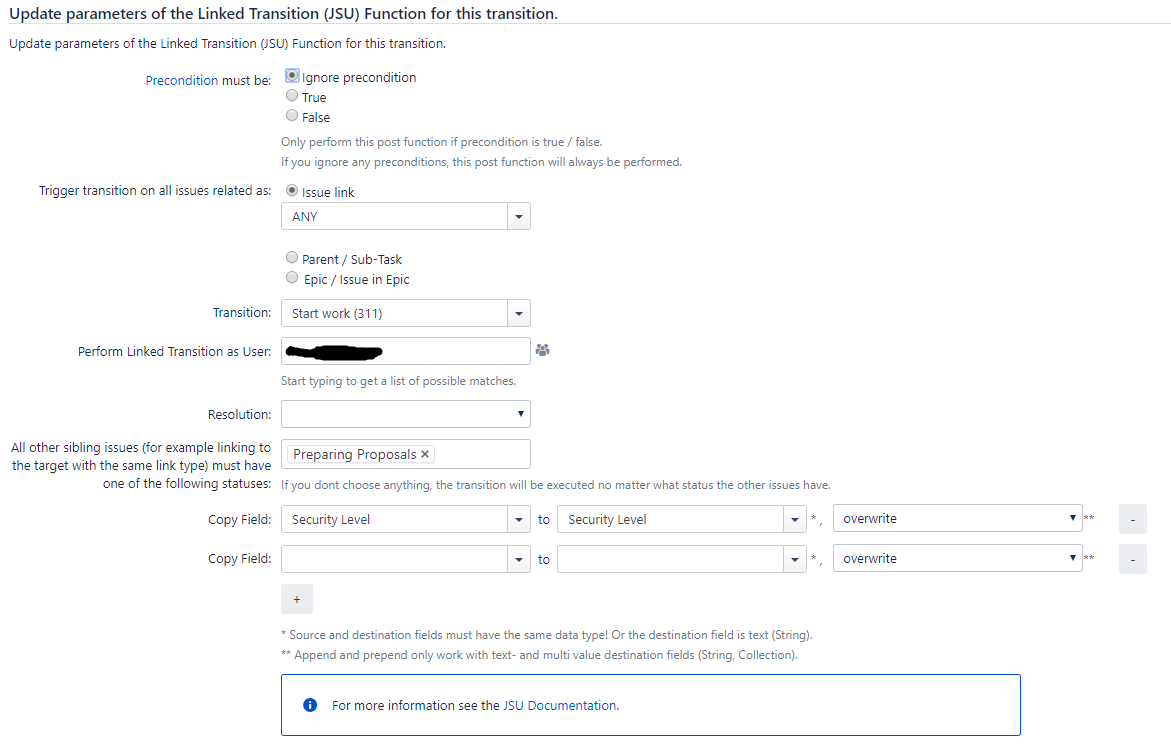

I've tried both "automation for jira"
and "JSU AUTOMATION SUITE FOR JIRA"
I've also confirmed that the transition I want to trigger doesn't have any conditions or screens and that the user that performs the trigger has permissions for it.

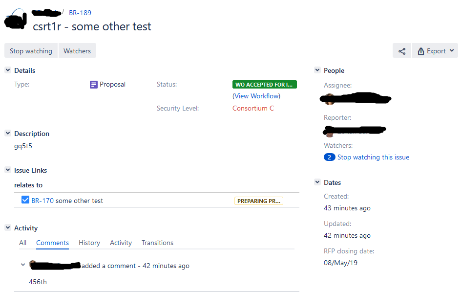

However, none of this worked. In the "Automation for jira" the log says no related issue is found. In JSU, seems to occur the same (from the logs): "/secure/WorkflowUIDispatcher.jspa [c.b.j.j.service.impl.LinkedIssueUtilImpl] Found 0 linked issues". This is strange because the link is there:
Can anyone help with some hints, please?
