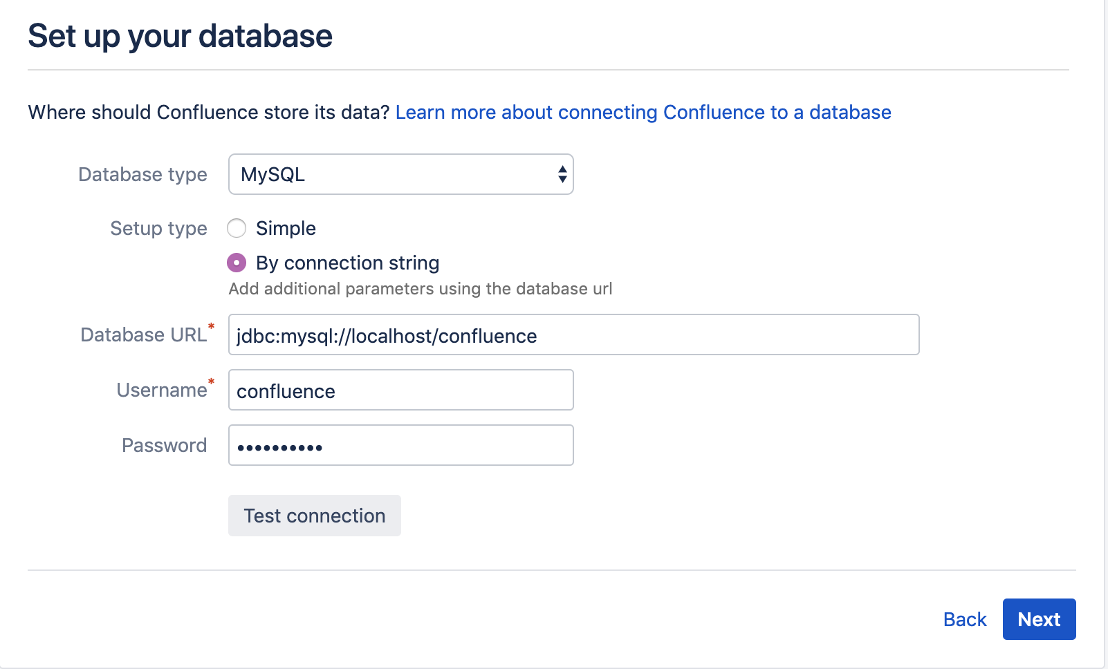

Both containers start when I perform 'docker-compose up' and I can hit the confluence page, but when it comes time to set up the database I can't for the life of me figure out how to connect to the mysql.
I've tried with 'localhost', 'mysql', the container name 'confl-mysql_1' all with no success:
Can't reach database server or port
SQLState - 08S01
com.mysql.jdbc.exceptions.jdbc4.CommunicationsException: Communications link failure The last packet sent successfully to the server was 0 milliseconds ago. The driver has not received any packets from the server.
