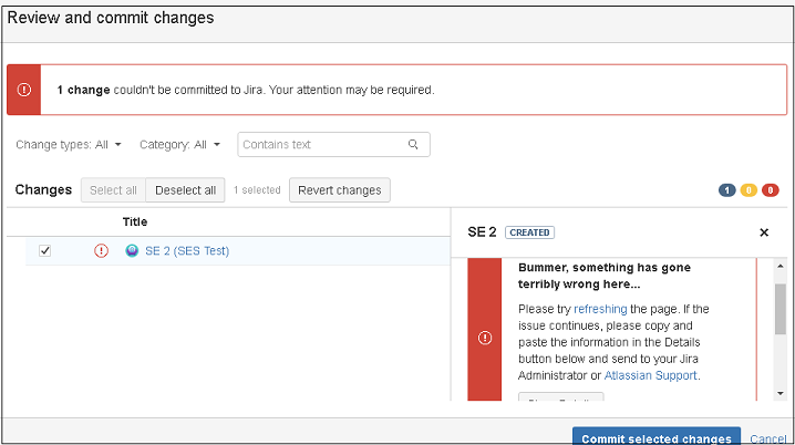

Problem 2 :
We created a release inside portfolio plan.
when we commit this release, we are getting error as shown in below screenshot.
Error in Log file :
2019-04-04 13:33:28,524 https-jsse-nio-6080-exec-47 url:/jira/rest/jpo/1.0/versions/commit username:user ERROR user 813x29052327x5 gzr3qd 10.217.60.89 /rest/jpo/1.0/versions/commit [c.a.r.j.c.scenario.common.BaseScenarioEntityCommitService] For input string: "SCEN-89be4826-e088-4195-b27d-a703bc6d2362"
java.lang.NumberFormatException: For input string: "SCEN-89be4826-e088-4195-b27d-a703bc6d2362"
at java.lang.NumberFormatException.forInputString(NumberFormatException.java:65)
at java.lang.Long.parseLong(Long.java:589)
at java.lang.Long.parseLong(Long.java:631)
at com.atlassian.rm.jpo.core.rank.DefaultIssueDomainKeyRankService$1.convert(DefaultIssueDomainKeyRankService.java:35)
at com.atlassian.rm.jpo.core.rank.RangedItemKeyToRankIdService.parseDefaultRange(RangedItemKeyToRankIdService.java:125)
at com.atlassian.rm.jpo.core.rank.RangedItemKeyToRankIdService.get(RangedItemKeyToRankIdService.java:108)
at com.atlassian.rm.jpo.core.rank.BaseKeyRankService.rankAfter(BaseKeyRankService.java:205)
Creating Epic in portfolio plan and committing it is working fine.
Error occurs only when creating release and committing.
Please help to solve the issues.
