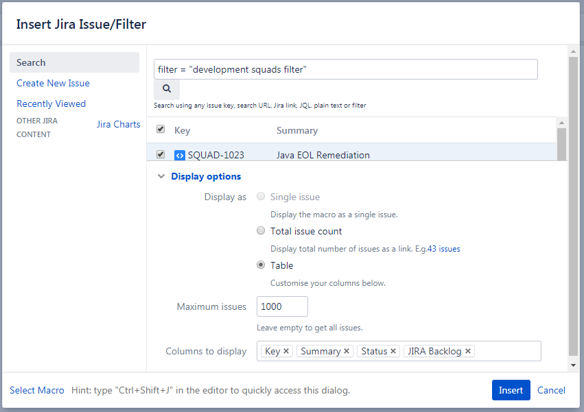

I have a simple Confluence page setup where I inserted the Jira Issue/filter macro onto the page. I have a filter setup for this macro and my issues display. The problem is where one of the fields displays the ID number and not the normal name that should be showing.
Here's my configuration of the macro. The column that is showing incorrectly is "Jira Backlog" on columns to display. This is a project picker custom field.

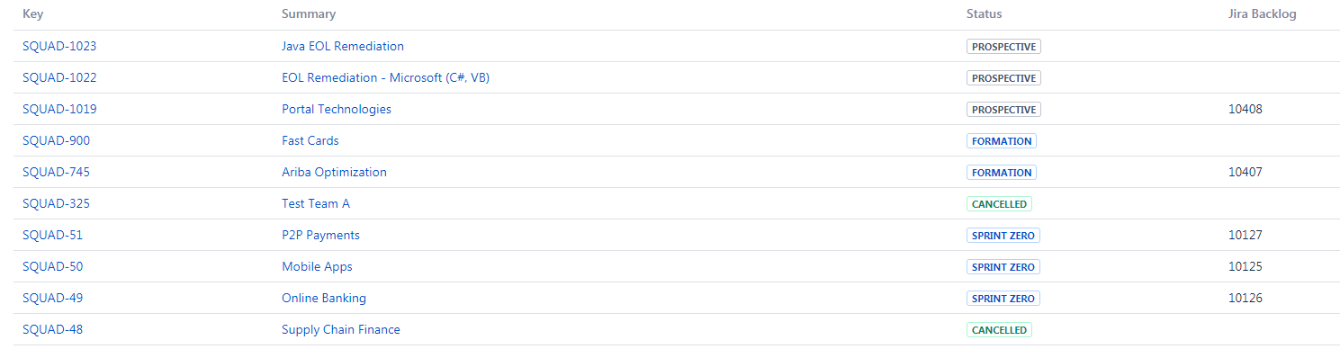

The Confluence page looks like this. Notice how the Jira Backlog column shows numbers and not the normal name of the project. I'm expecting to see the project name here. How do I get it to show the project name and be a clickable link to take me to that project? My filter in Jira acts like this perfectly fine in Jira v 7.13.0.
