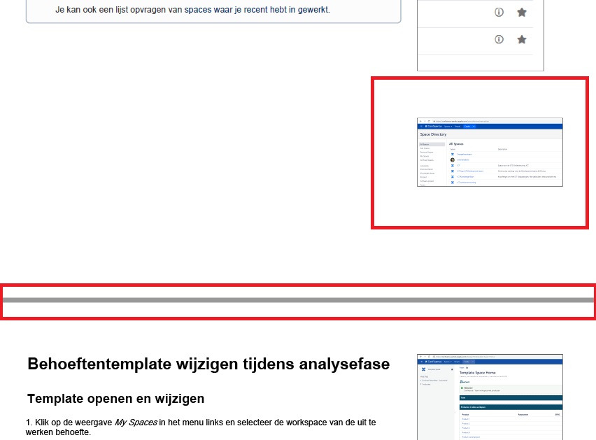

By use of the pagebreak macro I can control pdf page layout for the main text column of the sections, but apparently the same macro doesn't affect the content in the right sidebar. In my PDF export the screenshots in the right sidebar are being displayed on the wrong page (see screenshots below).

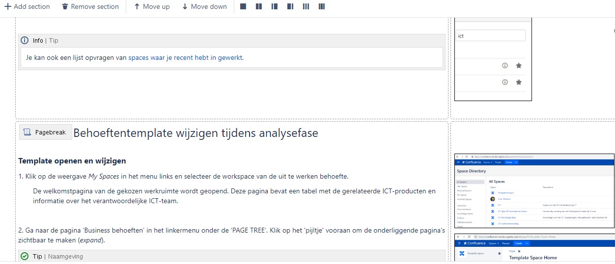

Some screenshots to further detail the situation:
1. Sections in Confluence with correct layout and 'pagebreak' for the new section:
2. Export to PDF with incorrect layout:
