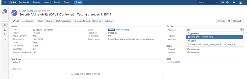

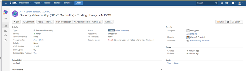

All Clones are properly created, but for these 2 Cloned issues instead of the associated Full Name for the account appearing as the Assignee, it is the value entered within the " "". (1st screenshot). No notifications are sent to the account, and using filters it does not show as being assigned to that account.
Attempts to assign from the View screen shows the erroneous entry along with the actual entry. (2nd screenshot)
