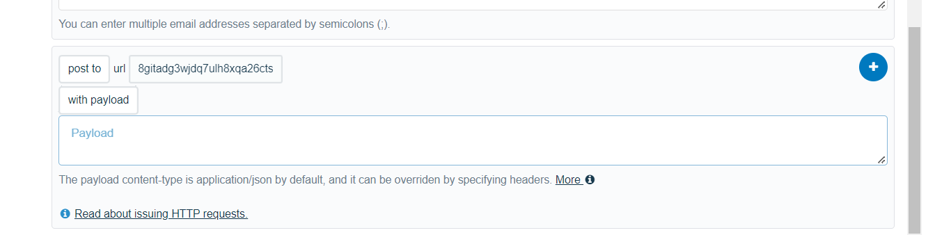

Hey, I want to use a button on a Trello card to send details to another application (Make/Integromat)
I tried to use the butter automation on Trello for posting webhooks and couldn't figure out how to send a few details of the card in the webhook.

also, which should I use, payload or header? I am new to webhooks so not sure how this goes
milynnus
October 22, 2022
@Fahad Sheji
What you are doing is http request … see
https://support.atlassian.com/trello/docs/issuing-http-requests/
and additionally you need to include the variables in the payload
for custom fields the variable is {{%customfieldname}}

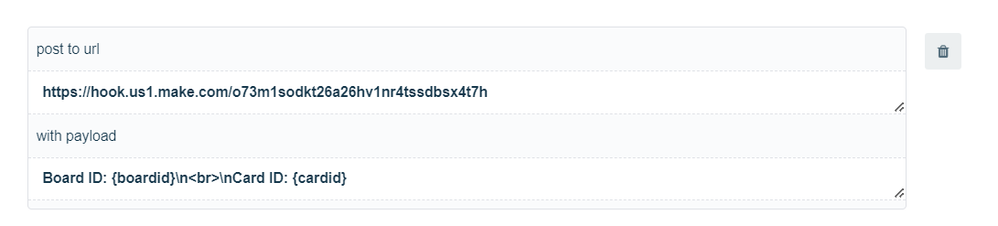

Fahad Sheji
October 23, 2022
Thanks, I want to send the board ID and Card ID which is {boardid} & {cardid}.
I read the link but couldn't figure out how to send the HTTP request, The one's I send get an error.
Could you help me out figure out what am doing wrong.
This is the post webhook I created but it doesn't work and I get an error
milynnus
October 24, 2022
@Fahad Sheji
payload should look something like
{"Board ID" : "{boardid}", "Card ID" : "{cardidlong}"}
Normal I work with cardidlong but if your endpoint is expect cardid go ahead and change it.
Make sure you have all the {, } and double quotes as shown.

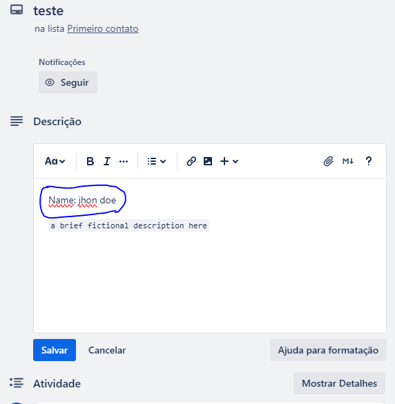

How could I pull what is in front of the text NAME: and send the name in the webhook, example: in the description of my card I have:
a brief fictional description here:
I would like to pull and send the name jhon doe in the webhook,
How do I insert the playload to get this information that is in the card description.
see exemle in image...
