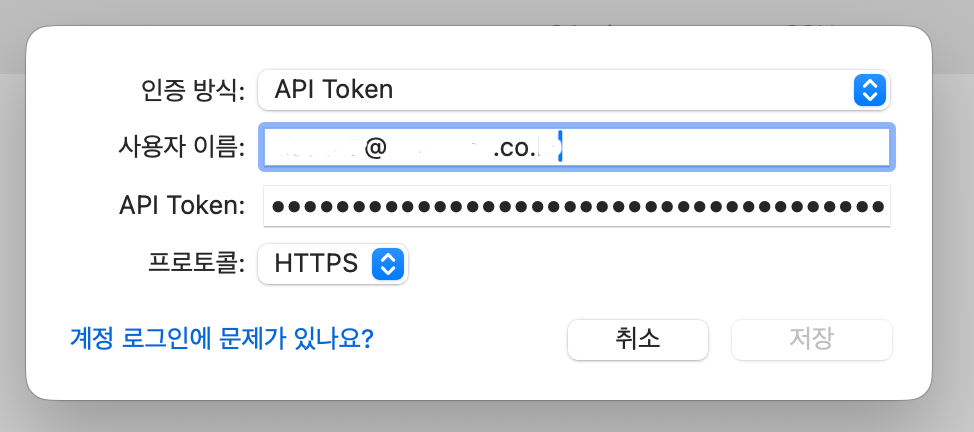

I am unable to register my account using an API Token in Sourcetree version 4.2.17 on macOS.
The "Save" button remains completely grayed out/disabled, making it impossible to proceed with the registration setup.
Interestingly, this exact same setup and token work perfectly fine on Windows.
What could be the reason for this issue on Mac, and how can I fix it?

허지수
June 16, 2026
Hello, @Pratap Guvvala
Thank you for your feedback. :)
The same API token is registered successfully in the Windows environment, but on this environment the button does not become active. Because of this, I was unable to find any error code or message that could help identify the cause.
Could you please check the attached screenshot?

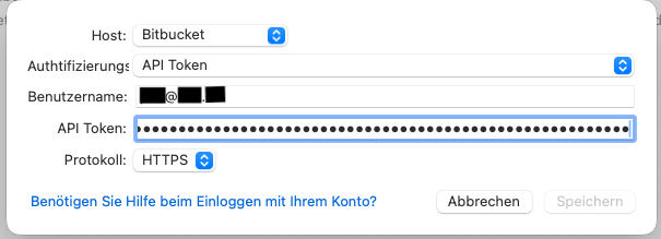

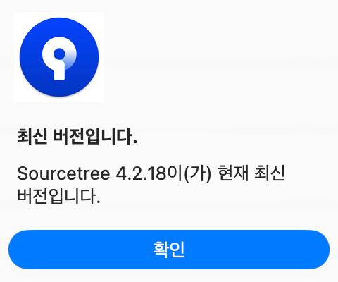

priskahuber
June 23, 2026
It's still not working on Mac. Sourcetree Version 4.2.18.
"Save"-Button is still disabled.

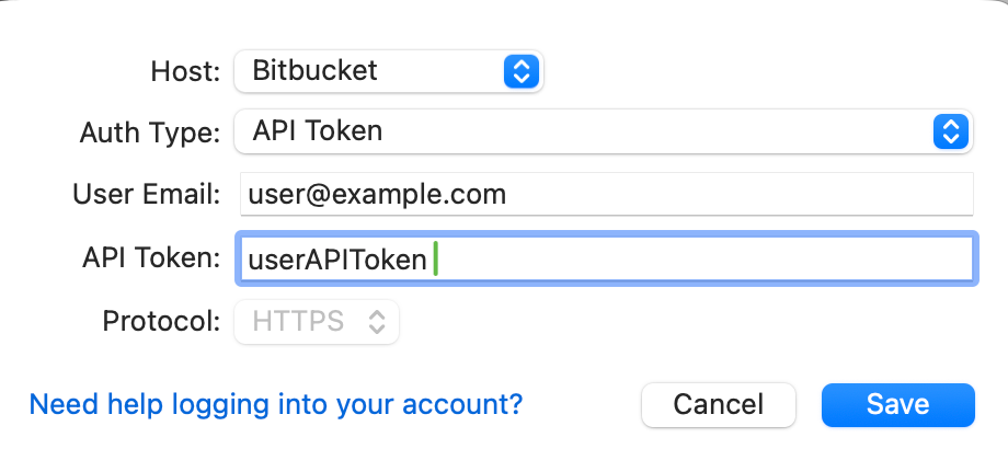

Tomislav Tobijas
July 2, 2026
@andrea_theconnective have you tried steps listed here https://community.atlassian.com/forums/Sourcetree-questions/Sourcetree-for-Mac-v4-2-17-quot-Save-quot-button-is-disabled/qaa-p/3256071#M47415
Basically this:
I found out that this problem only occurs when you have set a language other than English.
In my set, I used German. I changed to English, closed Sourcetree, opened Sourcetree and the Save button works for me.

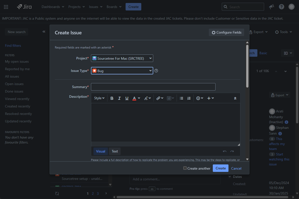

Tomislav Tobijas
June 9, 2026
Hey @허지수 ,
Did you manage to troubleshoot this? Or have you maybe found a workaround?
I did try to find open issues/bugs related to this on JAC, but didn't manage to do so. What you can do is to open a bug/ticket on there and state what you're experiencing.
Cheers,
Tobi

Tomislav Tobijas
June 2, 2026
Hey @허지수 ,
This is typically the case when you're using some incorrect formatted field in the account setup dialog.
Can you try following these steps: https://community.atlassian.com/forums/Sourcetree-questions/Unsure-how-to-use-the-API-password-with-sourcetree/qaa-p/3184506#M46897?
I don't have Mac, so I cannot test this out 🫤
Interestingly, you're saying the same thing worked on Windows and not here 👀
I think Mac does have something like Keychain Access where you can check stored credentials.
Have you tried using SSH authentication/key instead of API token? You should be able to generate a key within Sourcetree.
Cheers,
Tobi
