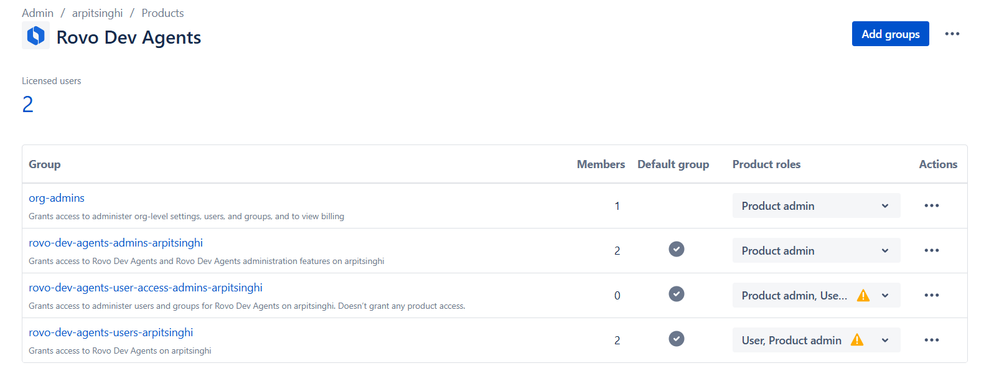

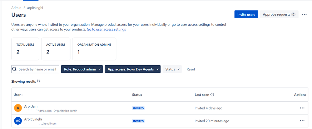

ArpitJain
July 1, 2025
Hi  Jovana,
I have invited myself and given rovodev permissions from admin page, both on my account as well as the other account i have created api key and tested but it doesnt work
i have also tried checcking in my admin interaface andi have permission to rovodev agents.
the status stays invited despite of accepting the invitation from the email
Authentication still fails. can you help?

Jovana Dunisijevic
July 1, 2025
Hey @ArpitJain
I am so sorry to hear you're still having issues with the authentication!
The most likely reason authentication is still failing is that your user status remains "invited" even after accepting the invitation, which means your account is not yet fully active in the system.
Sometimes, after accepting an invite, the user status does not update from "invited" to "active," and as a result, authentication will continue to fail even if permissions are set correctly.
Let's try this!
  • Double-check that you have fully completed the invitation process (sometimes this requires logging out and back in, or accepting the invite from a different browser).
  • Since you're the site admin, remove your user from the Rovo Dev Agents group, re-invite yourself, and accept the invite again.
  • If your status still shows as "invited" after these steps, this could be a backend provisioning issue in which case we'd have to go through the Atlassian support to look into that having your email and site details so they can manually activate your account. And for that you can raise a ticket here: https://rovodevagents.atlassian.net/servicedesk/customer/portal/1/group/1/create/45
Let us know how you go!
Jov

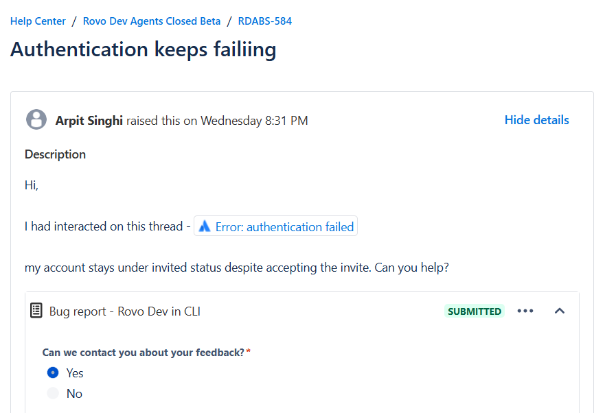

ArpitJain
July 7, 2025
I tried the method you suggested, but no one responds. it's ben more than 5 days now
