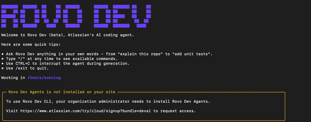

After running `acli rovodev run`, it says that Rovo Dev Agents is not installed on my site, even though I have already installed it. I can see that the Rovo Dev Agents appear in my Administration App directory.
Like # people like this

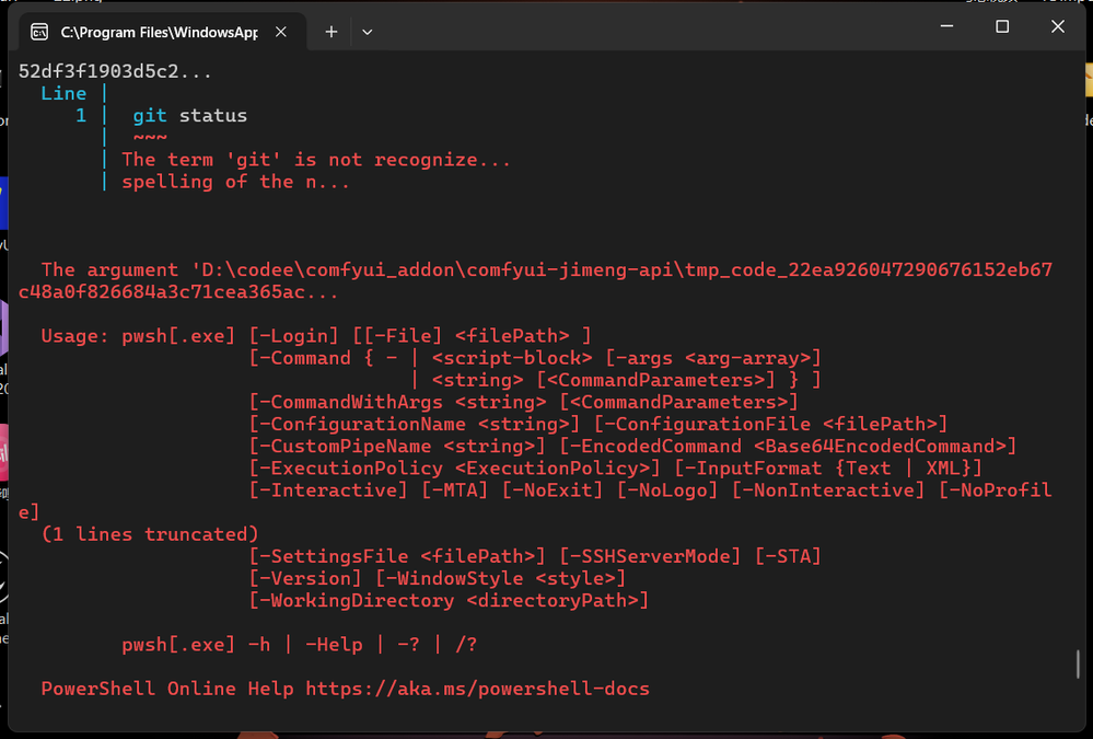

I found that he cannot properly recognize my local environment, such as uv, git, and other commands. Why is that?5d713c386dffee0c3f6951b16fd0ddc.png
Peter Wu
June 16, 2025
Hi @Kok Sing Hew
Thank you for trying our latest product.
Can you help to use this form to send us the following details? We will look into it.
  • OS and version
  • Shell (i.e. Bash, PowerShell, etc.)
  • ACLI version "acli --version"
  • Rovo Dev version "acli rovodev --version"
  • Rovo Dev log details from ~/.rovodev/rovodev.log
  • Site url
Thank you.

Peter Wu
June 16, 2025
Hi @wei siren
  • OS and version
  • ACLI version acli --version
  • Rovo Dev version acli rovodev --version
  • Site url
  • Repro steps
Thank you.

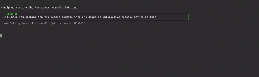

For operations that require human intervention, it is current stuck.  E.g: I asked Rovo to combine the two recent commits. It is right about using interactive rebase. But it is not showing me the editor to decide what to do with each commit.
I understand this kind of action is complex and asking for human's intervention makes sense.Screenshot 2025-06-17 at 17.21.22.png
Like [A9] William Kennedy likes this

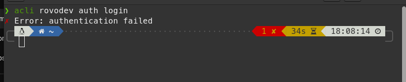

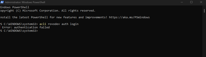

Even tho i have provided required email and API token still its not authenticating and getting authentication failed error...Any suggestions.

Just to update, i was using incorrect API token and using the correct token i am able to authenticate successfully.

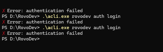

I get this error no matter what I do .✗ Error: authentication failed

i dont know why. but it say the authentication is failed. even i after double check the credential
