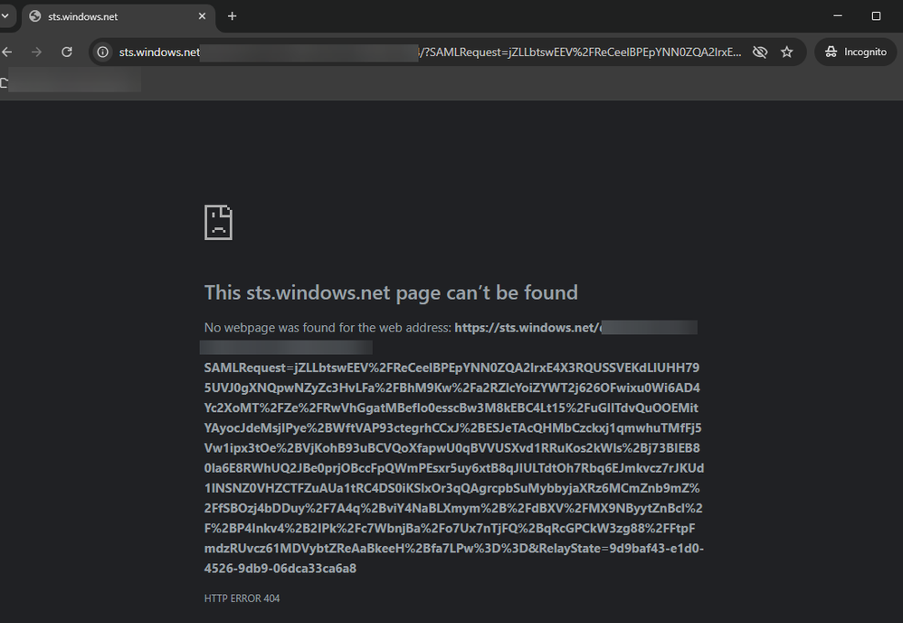

After completing all the documented steps and deleting and retrying the app configuration in Azure a few times, we still get this error when trying to configure SSO:
Browser error we get after clicking login and getting redirected from the login window:
This sts.windows.net page can't be foundNo webpage was found for the web address: https://sts.windows.net/xxxxxxxx-xxxx-xxxx-xxxx-xxxxxxxxxxxxxx?SAMLRequest=buaZHXoirzCQAsIdFm3ZLveZOnjKkuE1UOvZRlNWM1Ex0rKtlkkE8yxFFtLAawoSV5mjOaVjRt9lnFWclZExfl7BuJtpeEPkxOzslfi1O8iJB%2F3O%2B3dPtltyfR19cGJwG59MXPdP%2B%2BqOuL4bUdsrjSxWlR8j%2BJz5P3Nt6O6PPE3ay3zmj5O1oZ4443XkFQLQl%2BVCS6dX6A8G%2BnWZydX3RH%2B7OUqwG0WXWdV4gkWVy4f5%2Fr4g8%3D&RelayState=4b117eed-5515-4880-9131-32c2f36b7a91
HTTP ERROR 404
Any insights into the connection error?

Clearly I am a novice at this. Thanks for the assist @Hector Menchaca . Just raced through the instructions and did not follow them closely enough. Assumed the order they provided was the order to enter them in the SAML set up.

Hello @Minh Tran ,
In order to solve this issue you just need to swap the values Identity Provider Entity ID and Identity Provider SSO URL in your SAML configuration.
Regards,
Thanks!

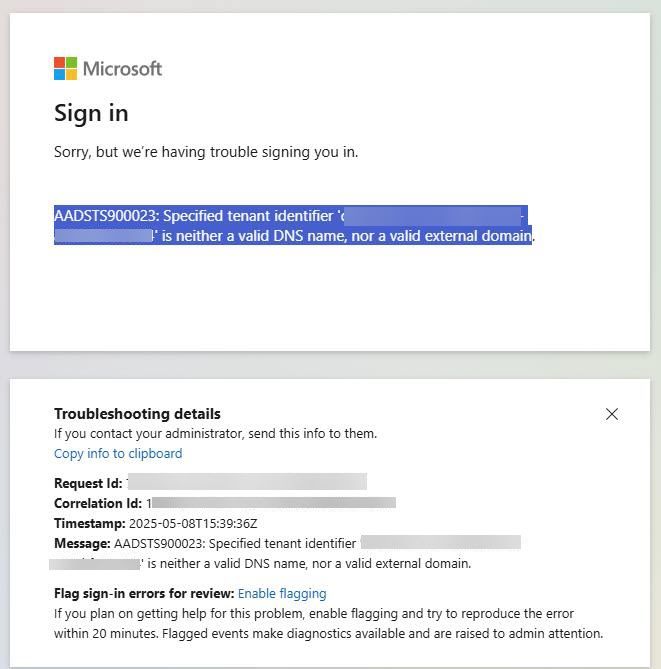

I am running into the exact same error. When I switched these as you suggest, I run into a new error: AADSTS900023: Specified tenant identifier 'REDACTED' is neither a valid DNS name, nor a valid external domain.
If you have any quick tips, I'd love to know!

jessica_huebner
May 8, 2025
Below are the steps I followed:
  1. My Entra Admin used Atlassian Cloud app.
  2. My Entra admin also changed the Entra Attributes & Claims so that Unique User Identifier is user.mail (our users' email addresses)
  3. In Atlassian Admin Center SAML config, we copied the values from service provider entity URL and Service provider assertion consumer service URL and set them in Entra as the default values in respective areas and saved
  4. From Entra, I copied the Login URL and Microsoft Entra Identifier and pasted them into Atlassian SAML config. I tried the following first (values on the left are Entra ID, values on the right are Atlassian Admin SAML Config page):
    1. Login URL > Identity Provider SSO URL
    2. Microsoft Entra Identifier > Identity provider Entity ID
Doing this gave me the same error as what Minh posted above (exception of course is our unique ID). Then, when I tried switching the values as you suggested, so that the Microsoft Entra Identifier was in the SSO URL field and Login URL was in the Entity ID field in the SAML config. The user got a different error: AADSTS900023: Specified tenant identifier...
I appreciate any guidance you may be able to provide!

jessica_huebner
May 8, 2025
Thanks for the clarification, Hector.
When I did this and had my test user try to sign in (Incognito), this is when she runs into the Microsoft error: AADSTS900023: Specified tenant identifier 'REDACTED' is neither a valid DNS name, nor a valid external domain (screenshot attached).image.jpg
