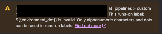

Unfortunately I got to another issue. When we set a variable like this as part of a runs-on label it shows an error that only alpha numeric characters and dots are allowed.
This happens with this configuration:
- variables:
- name: ENVIRONMENT_DOT
default: "de.dev"
allowed-values:
- "de.dev"
- "de.tau"
- "de.tst"
- "de.acc"
- "de.prd"
runs-on:
- ${{ENVIRONMENT_DOT}}
- self.hosted
- linux.shell
Yas_Bravo
March 17, 2026
@Remco TimmermanI don't think this feature is intended to be used that way
