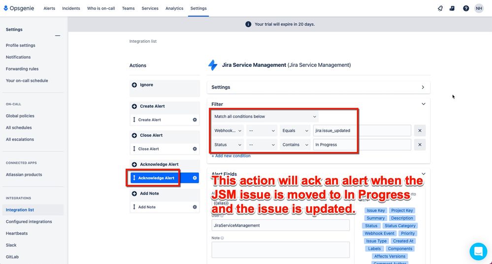

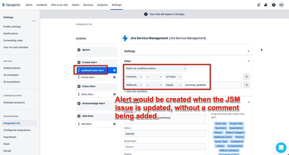

These actions can be defined under the integration's Advanced tab. Note this tab is only available on the Standard and Enterprise plans:
Here is where you can control what will happen to the Opsgenie alert when the JSM issue is updated, such as create an alert, ack it, etc. Examples:
Hope that helps! Let us know if you have any other questions.

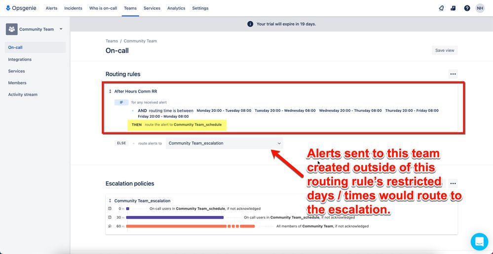

Seems like you could manage that - only notifying the on-call user(s) during off hours - under a team's On-call tab.
Routing rules can be restricted to times, or days/times - such as after hours - and have alerts created during these times send only to the team's on-call schedule:
Thanks Nick! I wrote an API script to get the team's on call person and then create an alert where they are notified but it is visible to team.
This seems to do same thing, but much easier!
