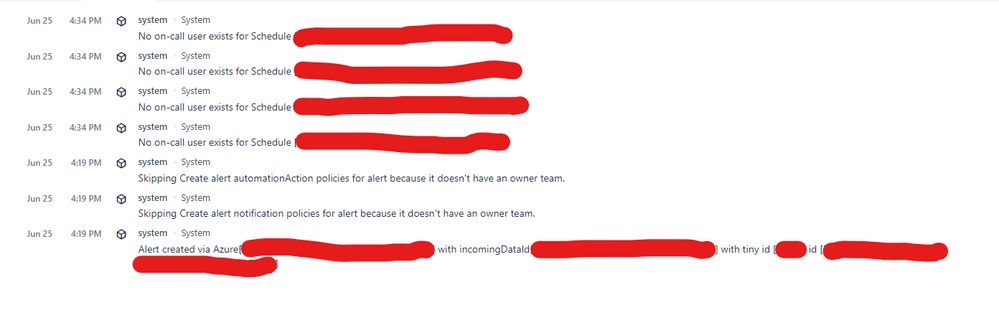

I've tried as you recommended, the delay is working, but the Zendesk integration wasn't triggered after the delay.
https://support.atlassian.com/opsgenie/docs/outgoing-integration-triggers-for-team-routings/
According to this article, the integration trigger should be working. Don't really know where I'm wrong though
