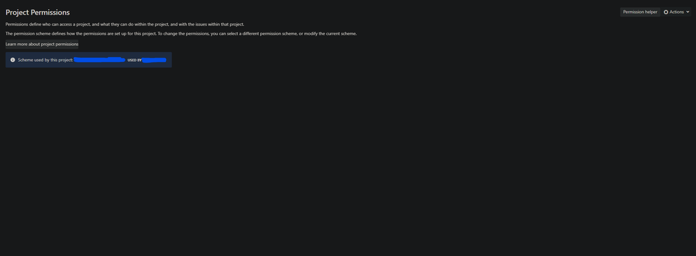

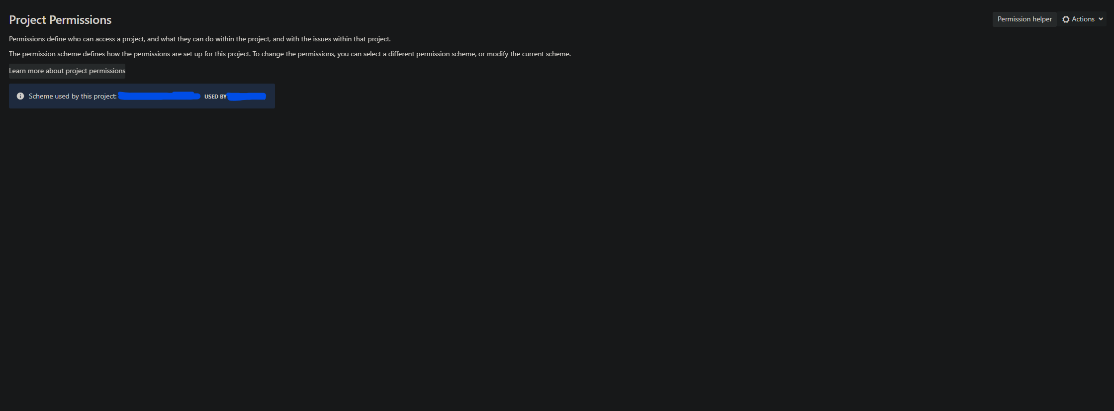

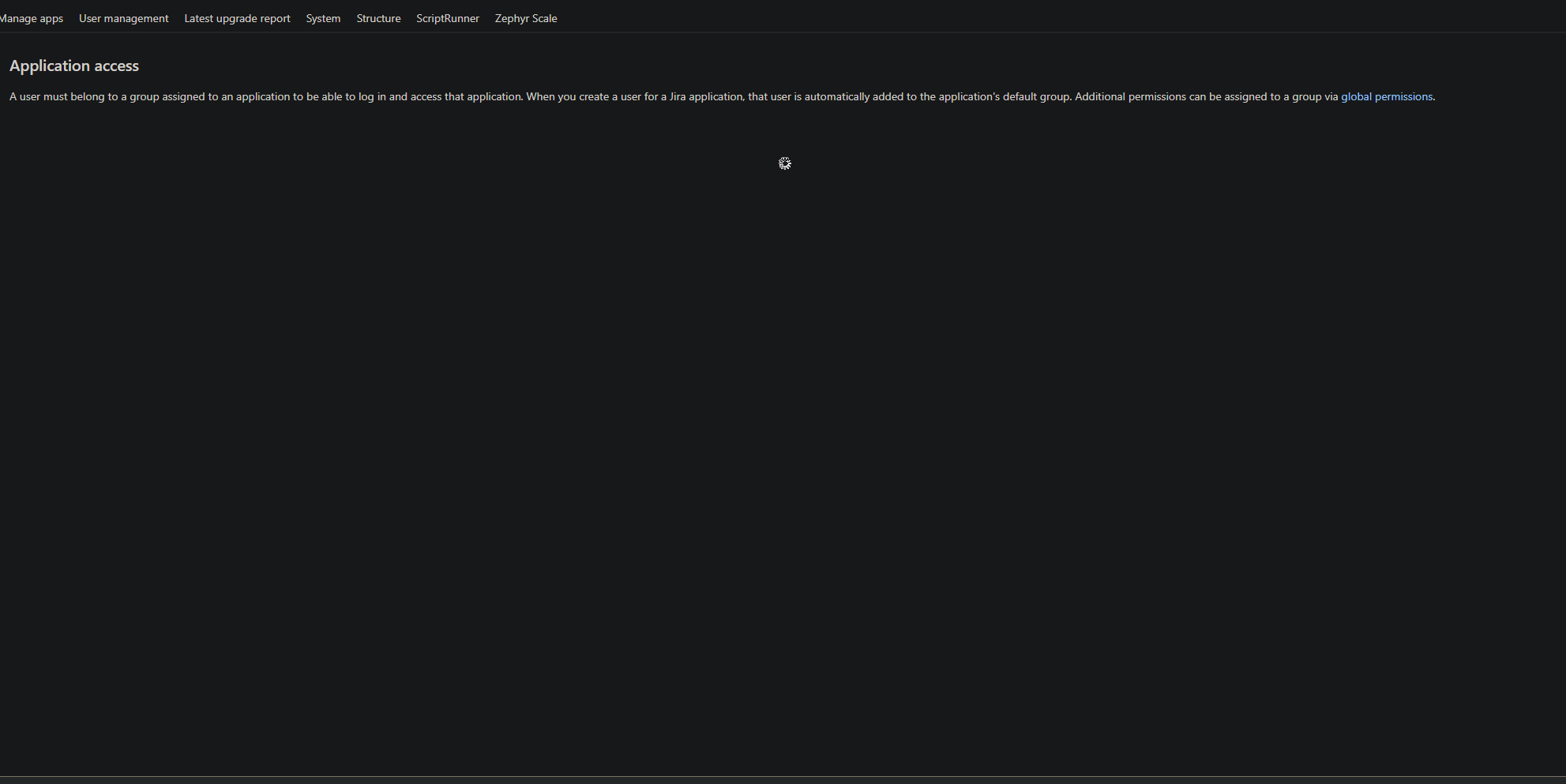

Buchelis_ Nikita April 2, 2024 edited
Good afternoon.
Upgraded jira dc without me from 9.1.1 to 9.12.4 and the guys said some permissions message popped up and they ignored it.
now if I go to the Application Access tab there is nothing there.
so in any project, the permissions is empty.
everything is working, but I would like to fix it.
Has anyone run into this?

Andrej Kováč September 10, 2024
So we figured it out, in our case it was the "Atlassian Hipchat Integration Plugin" which was blocking Application access and Project Permissions screens. Disabling it fixed the issue right away.
Buchelis_ Nikita September 12, 2024
Good afternoon, on the test server all this was broken by the plugin "Time to SLA".
on prod server 9.12.4 hipchat.
Radek Dostál
April 2, 2024
Do you see any errors in either javascript or http requests when opening those pages?
I would expect there to be a 500 with either an error, or a more detailed error with stacktrace in atlassian-jira.log
Can't say I'd see this in particular before, but when pages fail to load there is typically a problem with the data being "loaded", such as unique key constraints, null pointers, etc. So based off that stacktrace we can probably figure out more.

Buchelis_ Nikita April 5, 2024 edited
I turned off the reminder and the warning disappeared with it. But nothing changed in permission page.
applicattion access page

at org.springframework.aop.framework.ReflectiveMethodInvocation.proceed(ReflectiveMethodInvocation.java:186)
at org.springframework.aop.framework.JdkDynamicAopProxy.invoke(JdkDynamicAopProxy.java:241)
at com.sun.proxy.$Proxy2534.isFeatureEnabledForAllUsers(Unknown Source)
at com.atlassian.plugins.hipchat.api.DefaultHipChatDarkFeatureService.isInviteToHipChatEnabled(DefaultHipChatDarkFeatureService.java:25)
at jdk.internal.reflect.GeneratedMethodAccessor1751.invoke(Unknown Source)
at java.base/jdk.internal.reflect.DelegatingMethodAccessorImpl.invoke(DelegatingMethodAccessorImpl.java:43)
at java.base/java.lang.reflect.Method.invoke(Method.java:566)
at org.springframework.aop.support.AopUtils.invokeJoinpointUsingReflection(AopUtils.java:344)
at org.eclipse.gemini.blueprint.service.importer.support.internal.aop.ServiceInvoker.doInvoke(ServiceInvoker.java:56)
at org.eclipse.gemini.blueprint.service.importer.support.internal.aop.ServiceInvoker.invoke(ServiceInvoker.java:60)
at org.springframework.aop.support.DelegatingIntroductionInterceptor.doProceed(DelegatingIntroductionInterceptor.java:137)
at org.springframework.aop.support.DelegatingIntroductionInterceptor.invoke(DelegatingIntroductionInterceptor.java:124)
at org.eclipse.gemini.blueprint.service.util.internal.aop.ServiceTCCLInterceptor.invokeUnprivileged(ServiceTCCLInterceptor.java:70)
at org.eclipse.gemini.blueprint.service.util.internal.aop.ServiceTCCLInterceptor.invoke(ServiceTCCLInterceptor.java:53)
at org.eclipse.gemini.blueprint.service.importer.support.LocalBundleContextAdvice.invoke(LocalBundleContextAdvice.java:57)
at com.sun.proxy.$Proxy4070.isInviteToHipChatEnabled(Unknown Source)
at com.atlassian.plugins.hipchat.admin.ConfigureIntegrationDataProvider$1.call(ConfigureIntegrationDataProvider.java:59)
at com.atlassian.plugins.hipchat.admin.ConfigureIntegrationDataProvider$1.call(ConfigureIntegrationDataProvider.java:55)
at java.base/java.util.concurrent.FutureTask.run(FutureTask.java:264)
at java.base/java.util.concurrent.ThreadPoolExecutor.runWorker(ThreadPoolExecutor.java:1128)
at java.base/java.util.concurrent.ThreadPoolExecutor$Worker.run(ThreadPoolExecutor.java:628)
at java.base/java.lang.Thread.run(Thread.java:829)
