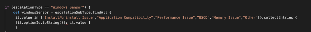

I am trying to do a few if/else if statements to modify the values of escalationSubType based on the value of escalationType. Can anyone help me with this sytax error?  Screen Shot 2022-08-22 at 2.42.20 PM.png

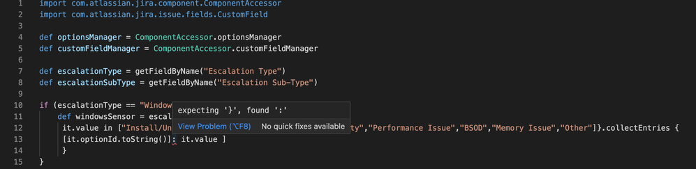

We can't tell you, you've snapped a screenshot where the pop-up box is obscuring the error.
Julia
August 22, 2022
The pop up box is the error and it is for the red underlined portion
[it.optionId.toString())]: it.value ]

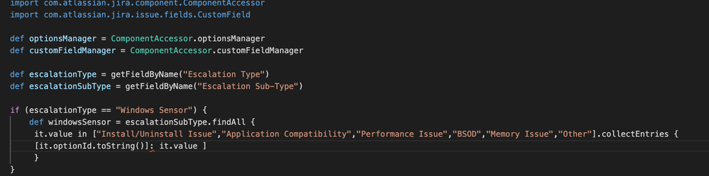

Julia
August 22, 2022
Nic Brough -Adaptavist-
August 22, 2022
Ok, now we can check what is behind it, we can point you to the } that is place in line 3 too early in the code, before the .collectentries.
