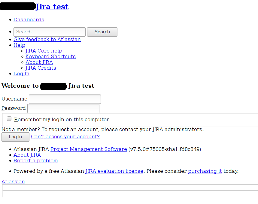

I've setup Jira to run on my.lan.net:8080 and now would like to add Nginx as a reverse proxy. I've made the edits following the guide here: https://confluence.atlassian.com/jirakb/integrating-jira-with-nginx-426115340.html. It seems something is amiss however. The login page is missing all CSS or something.
I can't quite figure out what I've goofed up. Anyone know where to look for clues? Are all four connector configurations required for this or am I supposed to only pick one? Not sure from the docs. My intention is to run Jira on the localhost interface
only and have Nginx handle the outside-world communication stack. Perhaps this is not possible?

Josh Steckler
September 26, 2017
In your server.xml you cannot have two connectors on the same port. Remove one of them.
Second, your nginx config forces users to use https. This is good, but your only needed connector is this:
<Connector port="8080"
maxThreads="150"
minSpareThreads="25"
connectionTimeout="20000"
enableLookups="false"
maxHttpHeaderSize="8192"
protocol="HTTP/1.1"
useBodyEncodingForURI="true"
redirectPort="8443"
acceptCount="100"
disableUploadTimeout="true"
proxyName="my.lan.net"
proxyPort="443"
scheme="https"
secure="true"
