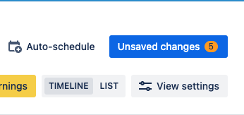

Hello @Mike Nuijs
When working with a Plan the feature allows you to make changes in the Plan to see how those changes will affect the Plan overall, without immediately committing the changes to the underlying issues.

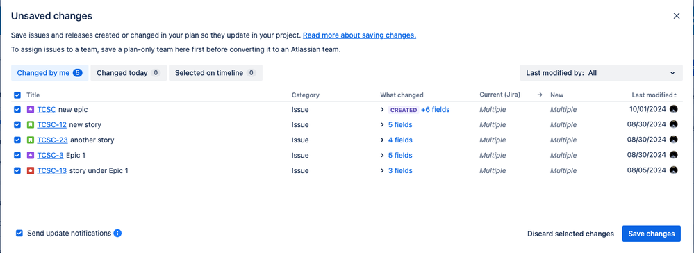

If you want to commit the Plan changes to the underlying issues, you have to click on the Unsaved Changes button in the upper right corner.
Make sure there are checkboxes next to the issue where you want the issue to be updated by the changes you made in the Plan, then click the Save button in the lower right corner.
https://support.atlassian.com/jira-software-cloud/docs/save-changes-made-in-advanced-roadmaps/
