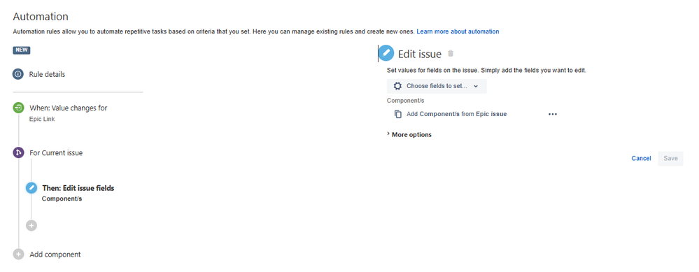

Our project uses multiple components on epics, features, stories, and tasks. I am trying to create a JIRA automation rule to copy one specific component to a child issue when created or epic link is edited.
I am able to create the rule to copy all components from the epic based on the epic link - values changed trigger, but the use case I have is to copy one specific component out of many.

Cayce McCraw
April 15, 2025
Thank you for helping me! I've entered the JSON based on documentation above, however, I am receiving errors saying JSON is not valid.
Bill Sheboy
April 15, 2025
First, you are using Jira Server / Data Center, and so the JSON documentation for that version may be found here: https://confluence.atlassian.com/automation/advanced-field-editing-using-json-993924663.html
Next, please read the JSON documentation carefully, and note I also described looking at the Labels field for an example to use the "update" attribute.
As an example for the Components field, that would be this for the values you show:
"update": {
"components": [
{ "add": { "name": "FPS O&M" } },
{ "add": { "name": "FPS Program" } }
Also note well: in the Edit Issue action, you have selected the Components field from the dropdown list AND used JSON.  Only one of those can be used at a time for the same rule action for a single field.  De-select the field from the dropdown list.

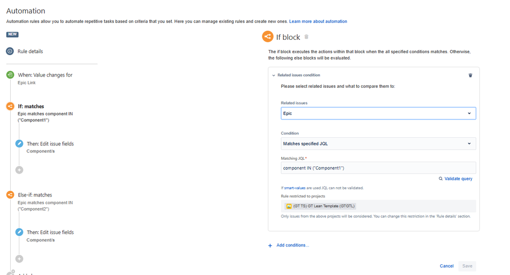

Cayce McCraw
April 15, 2025
Thank you for the quick response - I was able to successfully use the above to add both components, however, my initial question may not have been clear. I need to "copy down" or "add" either "FPS O&M" or "FPS Program" components depending on which component the Epic has - the epic would have one or the other, but not both. The epic could also have additional components such as multiple team names/components, so a straight copy of all components down to the story or task level wouldn't work either as stories and tasks would be worked by different teams.
I really do appreciate your time, and hopefully this clarification will help get us closer to resolving my dilemma!
Bill Sheboy
April 16, 2025
Thanks for clarifying the scenario, and...
When you want to selectively add one or the other Component, please use an if / else block in your rule to make that decision with conditions.
Like Cayce McCraw likes this
Cayce McCraw
April 16, 2025
Thank you so much for your assistance!!! The JSON was a game changer, thank you!
Like Bill Sheboy likes this

Cayce McCraw
April 16, 2025
I need to copy down one out of many components to the story and task created under a specific epic, not all the components from the epic.
Scenario: Epic A has 3 components "Component 1", "Component 2", and "Component 3"
Given a new story or task is created
When the epic link is added/updated in the story or task
And the matching epic has "Component 1"
Then I want the automation rule to copy only "Component 1" to the story or task
And ensure "Component 2" and "Component 3" are not copied.
Davide Schillaci
April 16, 2025
Hi,
have you already tried setting a related issue condition based on Epic?
Then you should set the specific Edit issue action via JSON as already suggested in other comments.
Bests
Cayce McCraw
April 16, 2025
This is perfect and worked like a charm!!!! Thank you!!!!
