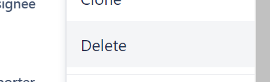

Lilach Mohager
September 5, 2022
There is another why to delete an issue?
I press this bottom ->
I have talk with BI they told me that the deleted issue cant be deleted from the DB, so I'm looking for a solution...
Nic Brough -Adaptavist-
September 5, 2022
Your screenshot is too limited to see what you are doing.
If, however, it is the one from the "issue options" menu (not the workflow), then I'm afraid I have to tell you that your BI team are talking utter *******s.
The delete from the tools menu destroys all the data in the database related to the issue.
