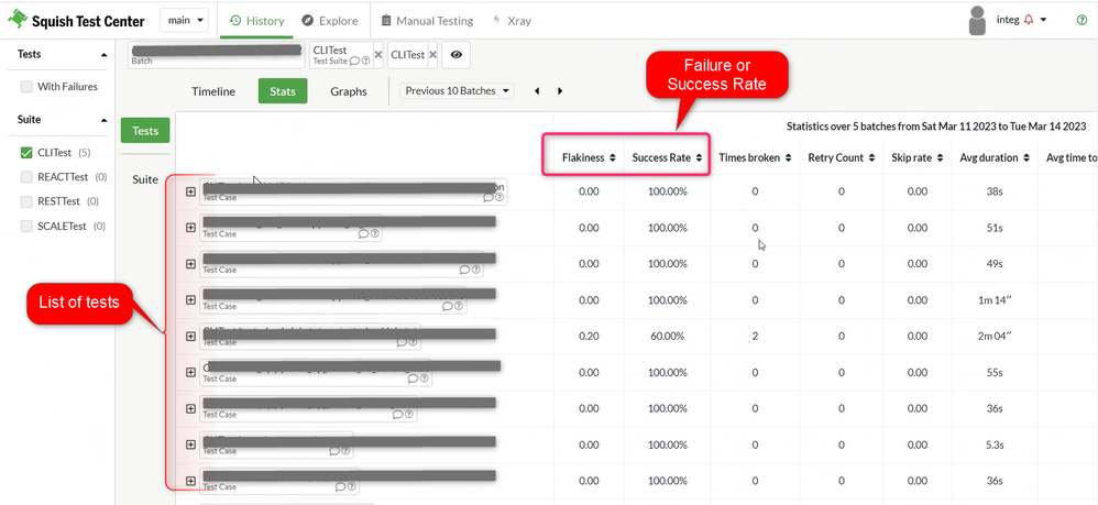

I can get a similar statistics from Squish Test Center. Please see image below:

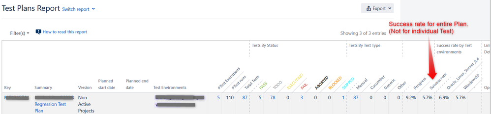

3. I was not able to find any column on the default XRay Reports or Test panel to get such a statistics. A similar statistics is available on Test Execution Report for "Success Rate" (please see image below) but that is applicable for the entire execution which may contain several tests. I would like to see it for individual tests.

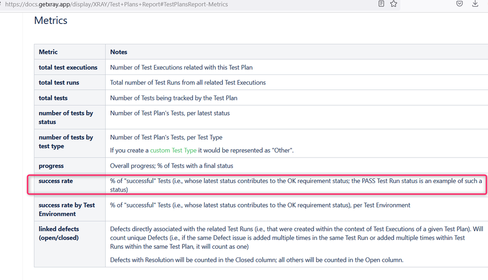

I believe you are talking about the documentation as shown in the image below:
I can see this metric in our Test Plan as below:
Unfortunately, this is not the number I am looking for. This Success rate is for the entire test plan and I am guessing it is = (Number of Passed Test) / (Total number of tests in the test plan that got executed)
The number that I am looking for is individual Test failure rate as described in my original query: Test failure rate = (No. of times a particular test failed) / (Total no. of times that particular test got executed). Here this particular test could have been executed in any number of test plans and considers the entire history of its execution.
