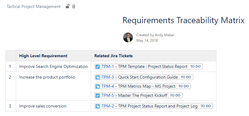

Hi - Here is a screen shot of a simple Requirements Traceability Matrix in Confluence using tasks/users stories or any JIRA issue type.
Just create table, manually enter the high level requirements and drag the detailed user stories into the table.
I find it very useful to break down high level requirements into user stories and track the delivery of the high level requirement to the detailed user story.
When you are first defining scope, it helps to identify the high level requirements and then map to the detailed requirements.
Let me know if you have any questions!

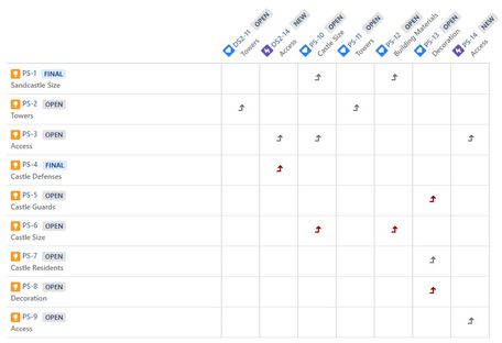

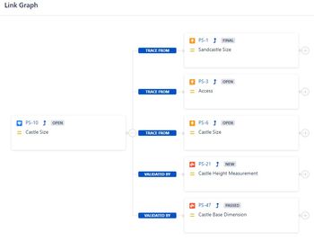

Additional to a flexible, free structure to organize any kind of issue in your hierarchical tree we
  • show the relation between single Jira issues as link graph
  • share the links between multiple issues as X-Y-Matrix

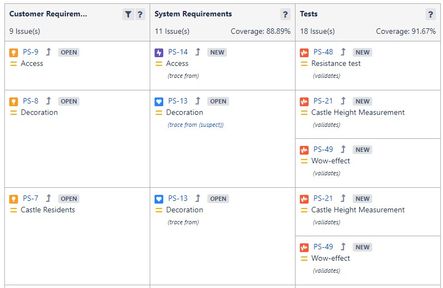

  • analyse the trace over connected link-chains as our Coverage View
