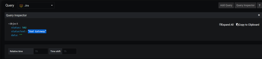

Hello.
I've been trying to get your solution to work. But metrics in grafana doesn't come up. It just says "Bad Gateway" when i use query inspector.

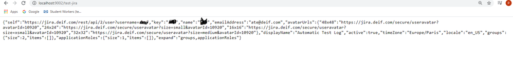

When I try the localhost it seems to work fine:
Ok if I got everything properly configured and working... how can I fetch or do queries ? sorry for noob question.
