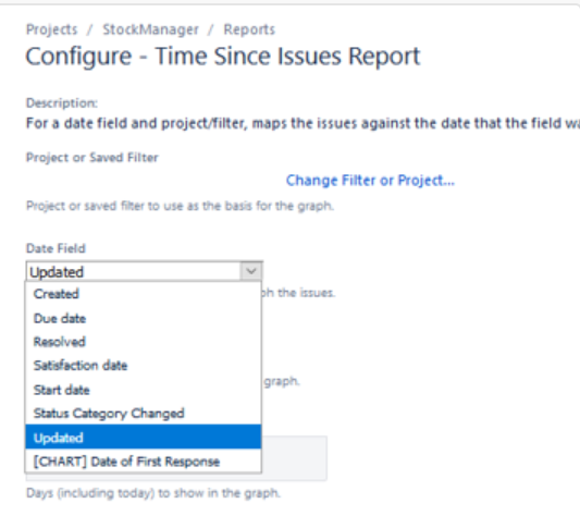

Hi,
I am looking for a report to show the count of issues worked on by development team over last x weeks. Only related report I see in jira is "Time Since Issues Report" - however,  date field configuration doesnt have any option to identify the time when issue is moved from "in progress" to "dev done".  I understand I need to create a custom field (Fix Date) that records current date when issue is moved from "in progress" to "done".
My question is - will the custom date field (Fix Date) be displayed in the date field configuration options for the report. If not, can someone suggest possible solution to get the report. Right now I only see following for date config:
Thanks.

This helps - I understand how I can capture the date when issues move from 'In progress' to 'Dev done'. However, I am still not sure if custom field details can be used for representation on graph/report.
If you take a look at screenshot attached in my question, which option should i select to see report based on custom field?

Hello Yogita,
Once you create your date custom field and add it to your project screens, it will appear as an option under the Date field you are displaying in your screenshot.
Let me know if this is not happening in your instance.
Yogita Manwani
April 24, 2019
It worked.
